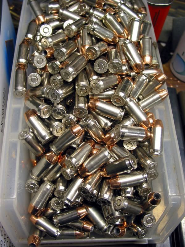

Not sure how one would account for equipment cost- i have a nice setup with a couple of dillons, and good casting equipment, couple thousand maybe in it.  I enjoy the aming ammo as much as i do shooting it so there are some factors other than cost and avaiability to consider.
Bottom line right now it feels pretty good to know i can turn a bin like this out in a couple hours if i need or want to:
