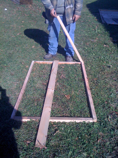

Note: This is a photo of v2.0 I am including it so the time we spent headscratching is acknowledged. :) Also the length of the center beam here is plenty for cutting out hand holds after assembly.

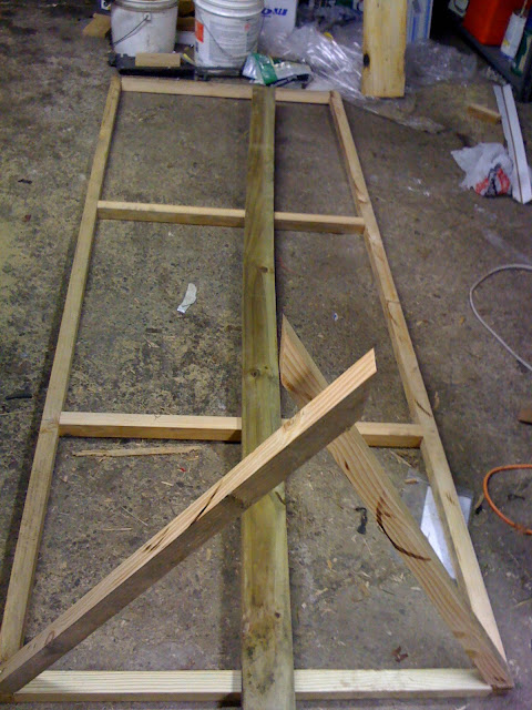

Step 4 - Create supports and finish the frame. We went with supports at 2ft then again at 5ft thus creating a 3x2 'Den' and providing a little support for the pasture which is the remaining 3x6 space.

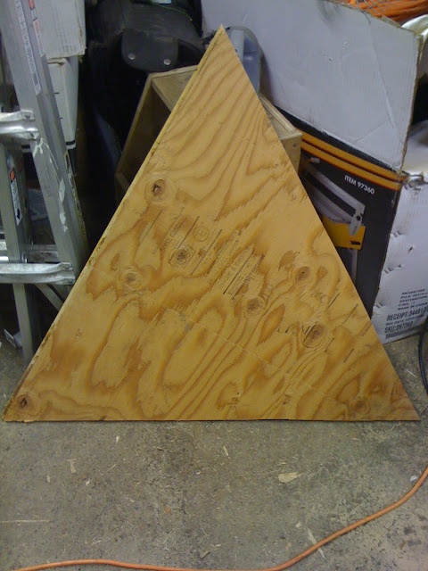

Step 5 - Cut out interior and exterior walls. This will help support the roofing, create a spot for the door which houses the feed hopper and divide the space.

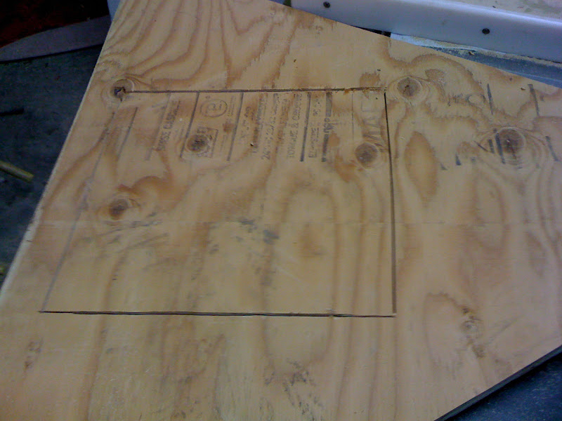

Step 6 - Cut out the door from the exterior wall piece. Make certain that if you are installing a feed hopper on the door that you place and measure it before you cut.
Keep the door small as anything too big will weaken the structure and will allow for rabbit escape routes.
Also leave a little lip along the bottom as when the does kindle their kits could be anywhere in the den also it elevates the feed hopper which makes less of a mess.

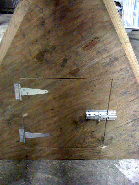

Step 7 - Install door hardware. I know that the hinges are larger than such a small door calls for but rabbits are kickers and coyotes are voracious. As you can see, the hardware overkill continues in the latch.
I have found that the smaller latches are thinner and thus get bent out of shape and are not built to take much punishment. Plus, these doors are going to be facing north where we get most of our wind

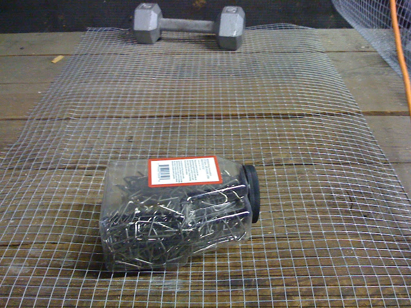

Step 8 - Cut the wire netting. I used .5"x.5" for the den flooring which I installed above the bottom wood frame.
The pasture flooring is 2"x4" so that the does can eat the clover but cannot fulfill their desire to dig a burrow.
All of the other sides are fashioned from 1"x2" wire, the pasture end is overlaid so as to provide structural support for heavy water bottles or anything else.
I also have "Baby Saver" mesh to overlay in the den when the does are kindling that I can put in and remove as needed.
By making the netting removable it keeps the den space cleaner while not compromising safety.

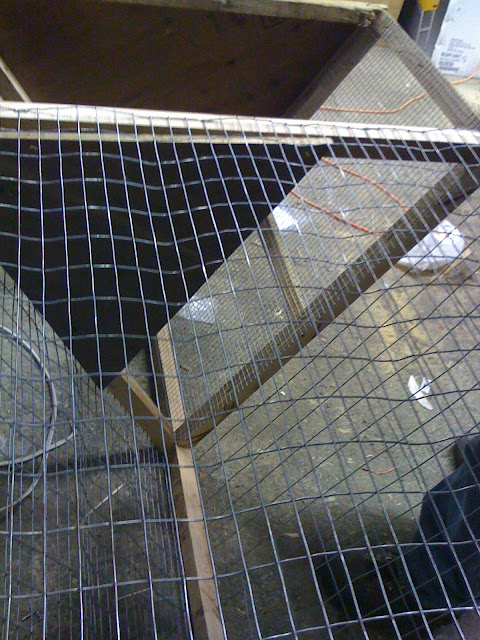

Step 9 - Install interior wall and exterior wall. Also, install the wire netting onto the frame.
We used thick staples to secure the wires since the usual staples pretty much pop right off if things are not well supported.
It helps to install wire for the den floor then attach the frame by the way otherwise you have to cut around the posts and those sharp edges are a pain to smooth out and secure.

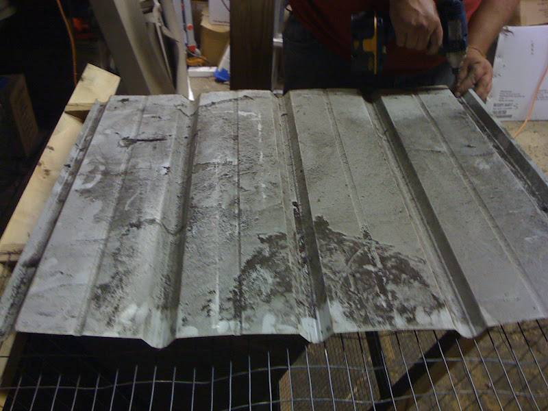

We used old galvanized roofing we found in the back of the barn, set it white side out to reflect as much heat as possible to keep the interior cool in the summer.
Keeping indirect air circulation by providing the vents between the roofing and the frame makes for happy bunnies.
