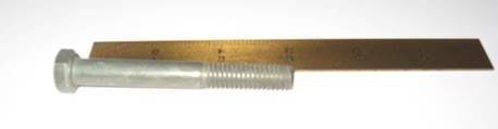

The following images will look at a grade 5 3 inch 3/8-16NC hex bolt.  What does all that mean?
The length of a bolt is measured from under the head to the end of the threaded shank; in this case, we have a 3 inch bolt.
The diameter of the bolt is measured across the largest part of the threads.  Bolts are generally made slightly smaller than their nominal diameter for ease of installation.  Here we have a 3/8 inch bolt, and as you can see, it measures .370”.  In theory this bolt would measure .375” there is a difference of .005, about the thickness of a hair.

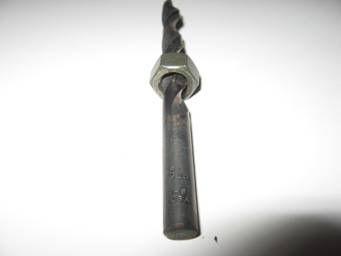

Now that we have a center hole in location, we drill with the correct sized bit.  How do we determine the correct size?  We could start with the bolt diameter, the number of threads per inch and the angle of the threads and do some math, but the easiest way is to refer to a handy little chart put together by any of several tool companies. According to the chart we need a 5/16” drill.  I’ve highlighted the pertinent information.
The 5/16” drill fits snugly through the corresponding nut, so it stands to reason that this is the correct size.

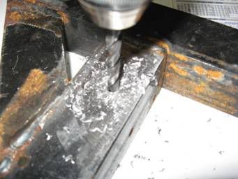

Our drill makes quick work of the hole.  I should note, it is important to get each bit perpendicular to the surface you are drilling.

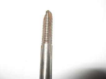

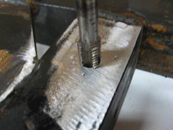

This is a 3/8-16 tap; imagine it as a really hard bolt with some areas cut away for the chips made by cutting the threads to fall through.  If you look closely, you will see that there is a taper on the end to gradually cut each thread.

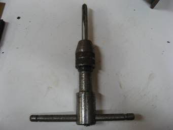

A tap has a square shank and is loaded into a tap handle.
We tap (cut internal threads in) the hole by applying downward pressure while twisting the tap handle in a clockwise direction.  Tap handles are shaped the way they are so you can apply force on both sides at the same time.  If you only pull on one side of the tap handle it will try to bend and possibly break the tap.  Because taps are so hard, they are brittle and will break easily.  A broken tap is one of the most difficult things to remove from a threaded hole, so take your time and twist the handle-- don’t bend.

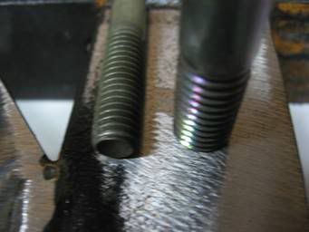

And we have the perfectly threaded hole.
Our bolt fits in with no problems.

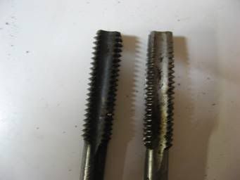

Remember when I said that the threads on a tap start at a smaller diameter and gradually get bigger?  Well sometimes you need to thread as far as possible down a hole that doesn’t pass all the way through a part.  In that case, you select a bottoming tap.  You start with a tap with more taper and then finish off with the bottoming tap to fully cut all the threads.  If you look closely you will see the difference, the tap on the left is a bottoming tap.  A bottoming tap is much harder to turn and to get started threading perpendicular to your work piece, so if possible use a tapered tap.
Back at our broken widget, we have drilled the hole with a 27/64” or .422 drill bit.  If you measure a drilled hole it is likely to be several thousandths of an inch larger than the drill.  We can see that this hole measures between .423” and .424”.  It’s nothing to worry about for our purposes, but if your drilled hole is much bigger, the drill bit may need resharpening.
Now we tap the hole with a 1/2-13 tap.  As you tap larger holes,  it is often necessary to go clockwise a fraction of a turn, then backwards.  This breaks the chips formed while cutting the threads.
And here we have our refreshed tapped hole.  Our old bolt is laying next to the new one to show the size difference.

Some further inspection of the bolt head shows us three radial marks, and the manufacturers stamp.  Strangely, if a bolt or nut shows no markings it tells us the bolt is grade 2, three marks means the bolt is a grade 5, and five marks indicate that the bolt is grade 8.  The grade is basically a measure of the strength of the steel used to make the bolt. There are specific industry standards for each grade, and even standards above and beyond grade 8.  The fasteners you will pick up at the local hardware store will probably be grades 2, 5 or 8.  The three marks indicate that that this particular example is a grade 5 bolt.
I know this is an old thread but...
In the past I read a lot about a problem with low quality foreign made or "counterfeit" bolts on the market... meaning they were grade marked but they would vary in their strength and hardly ever were up to the grade they were marked.  Is that still an issue? I do know that most fasteners that I buy now are not finished nearly as well as they used to be in years past. (They look cheap.)
