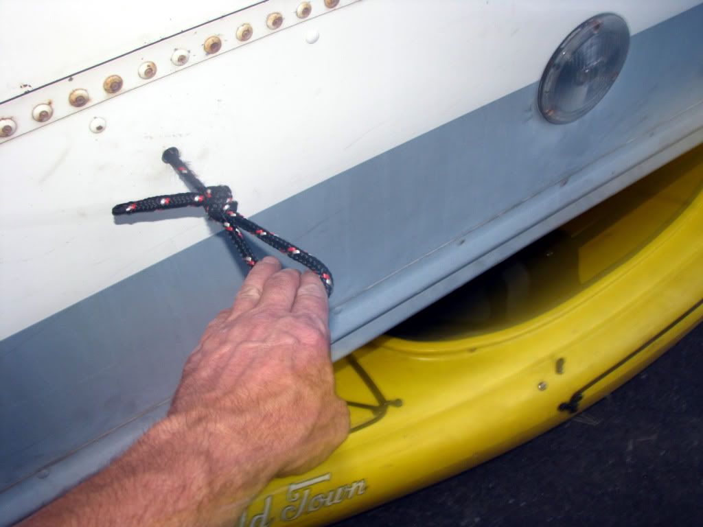

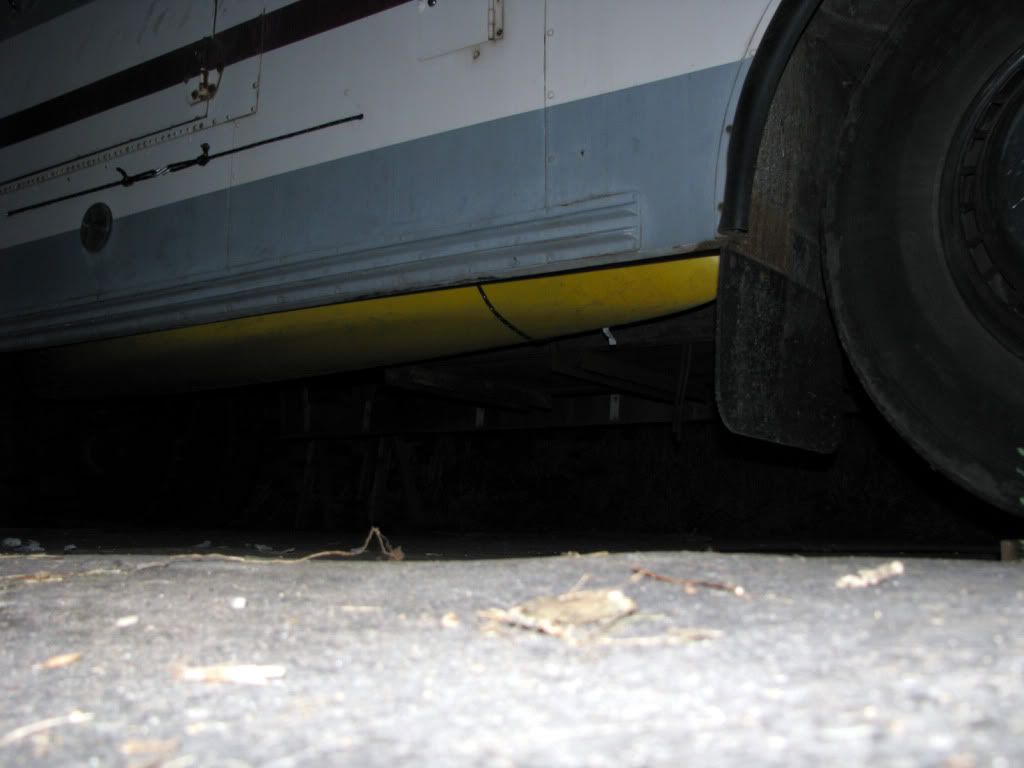

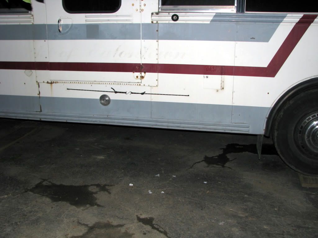

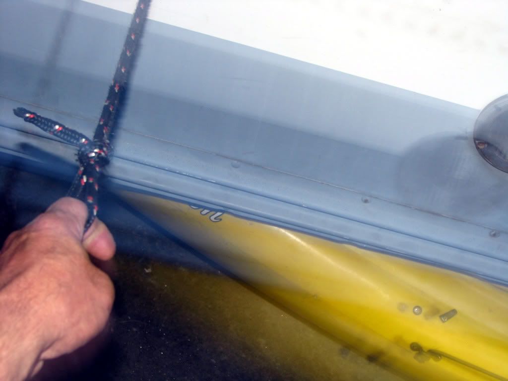

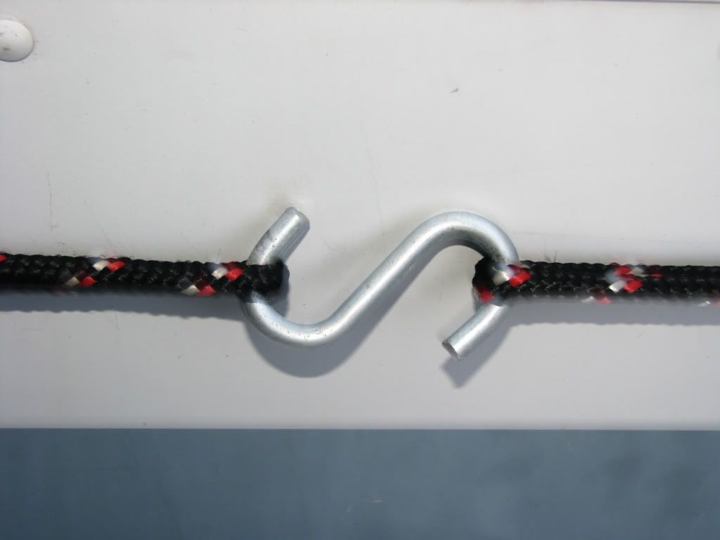

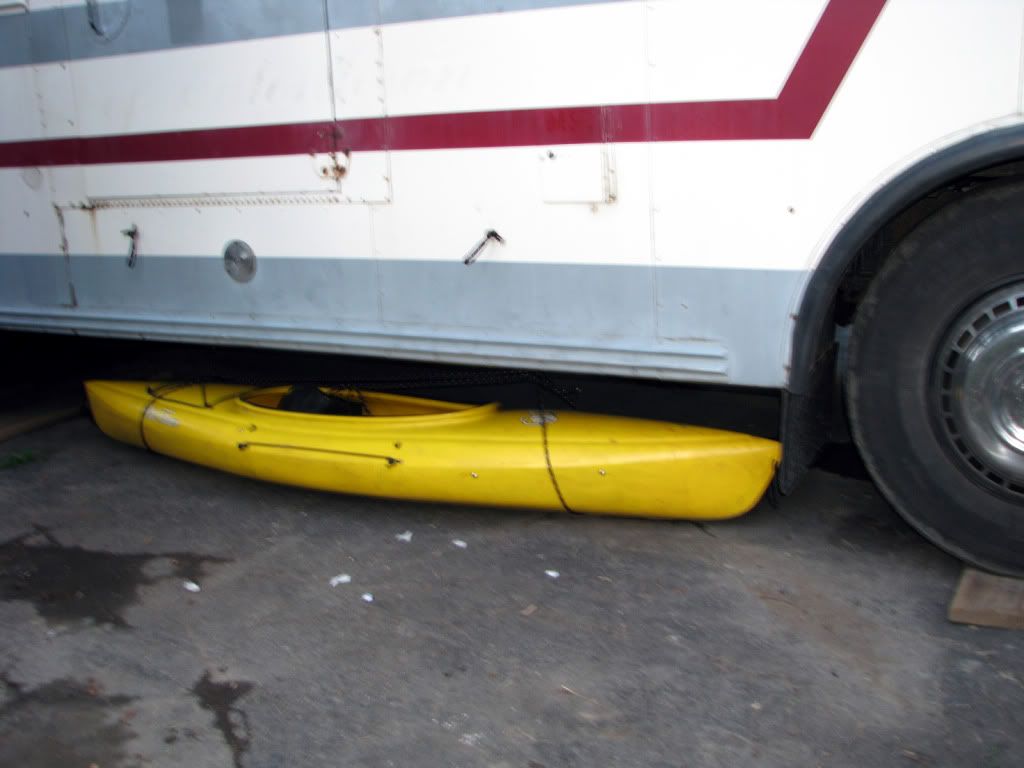

I've been doing a bunch of little stuff, getting ready for next weeks trip.  The first real 8 day excursion into the woods with the B.O.B.
I did take a few pics (sorry the quality is a bit off), of last nights project.  I need a place to carry my 2 fishing kayaks.  This is yet another fabulous thing about this model bus, particularly the rear engine.  It leaves a freaking TON of room underneath.  The underside is broken down into 3 sections, all run the entire length between the front and rear wheels.  The right and left sides, and of course the middle section.
The middle will be used for water tanks.  I have decided, since I now pull a storage trailer and have a pickup, (Yes I sold my Mazda 3 and bought a 2001 Toyota Tacoma 4x4), that I'm going to use each side for storing a kayak.  I will make storage in the area in front of the front tires.
Anyways, here is the pics of the crude, simple but HIGHLY effective harness I made for about $3 per kayak.
Here's the kayak sitting on the ground, with a simple loop around the front and back.  Each end comes out of a small hole I drilled for the rope to come out.
Here you can see the end of the front loop/rope coming out the side.
As you can see, I can simply pull on the loops to raise the kayak.  The ropes use a eye bolt mounted to the frame to support the kayak and make it easy to lift.
Once I pull each rope out, I simply slip an S link and this secures the ropes.
Once the ropes are fastened, you can't even see the boat tucked up under the sides.  Safe, dry and secure.  I put all the paddles and life vests inside each kayak.

 you might want to use some type of closed loop device to hold the ends together. maybe a carbiner or something similiar
and having a plastic on a thin rope like that might start to indent the kayak where it rests on the rope.  you might want to put some of those foam noodles on it to stop any damage...

ARCHER... GREAT ideas. I need to get better quality cord anyways, but augmenting with a clip will be a nice safety, and the noodle idea... That's using your noodle!  I was thinking about creating a sort of a cradle with an old piece of carpet, but the foam pool noodle is MUCH simpler.  I also need to find 4 small metal grommet/flanges to smooth out the holes that go through the sides to keep the rope from getting chewed up over time. I have filed them down, but I think I'll need more.

Also... great suggestion from Archer on the padding for the rope on the Kayak harness.  I went with foam pipe wrap, mostly because I had it lying around.  But it really kept the kayaks tucked in tight and protected the hulls from indenting from the rope. Thanks!!!!
