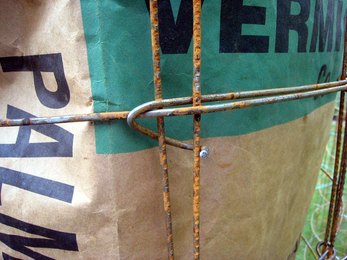

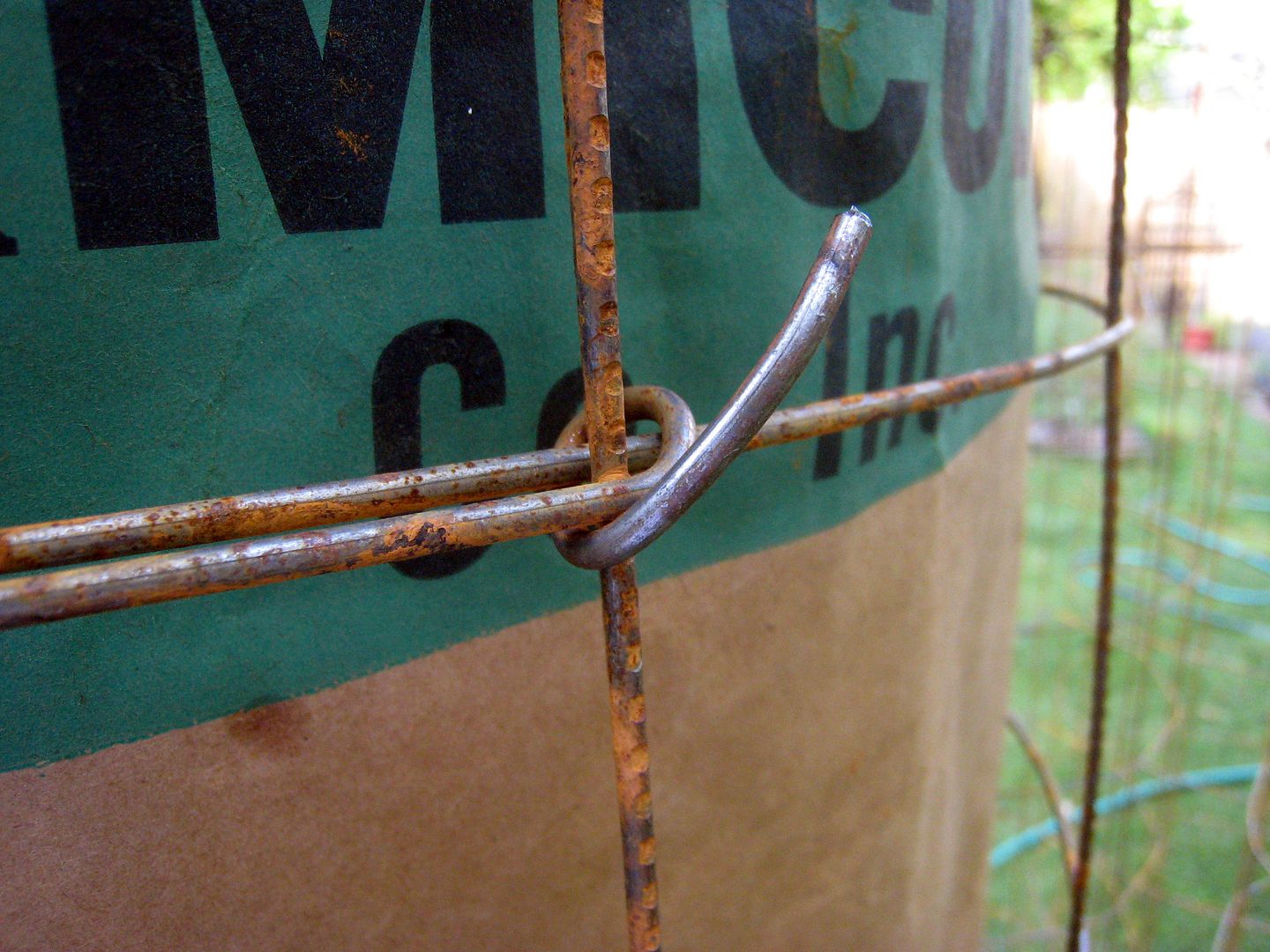

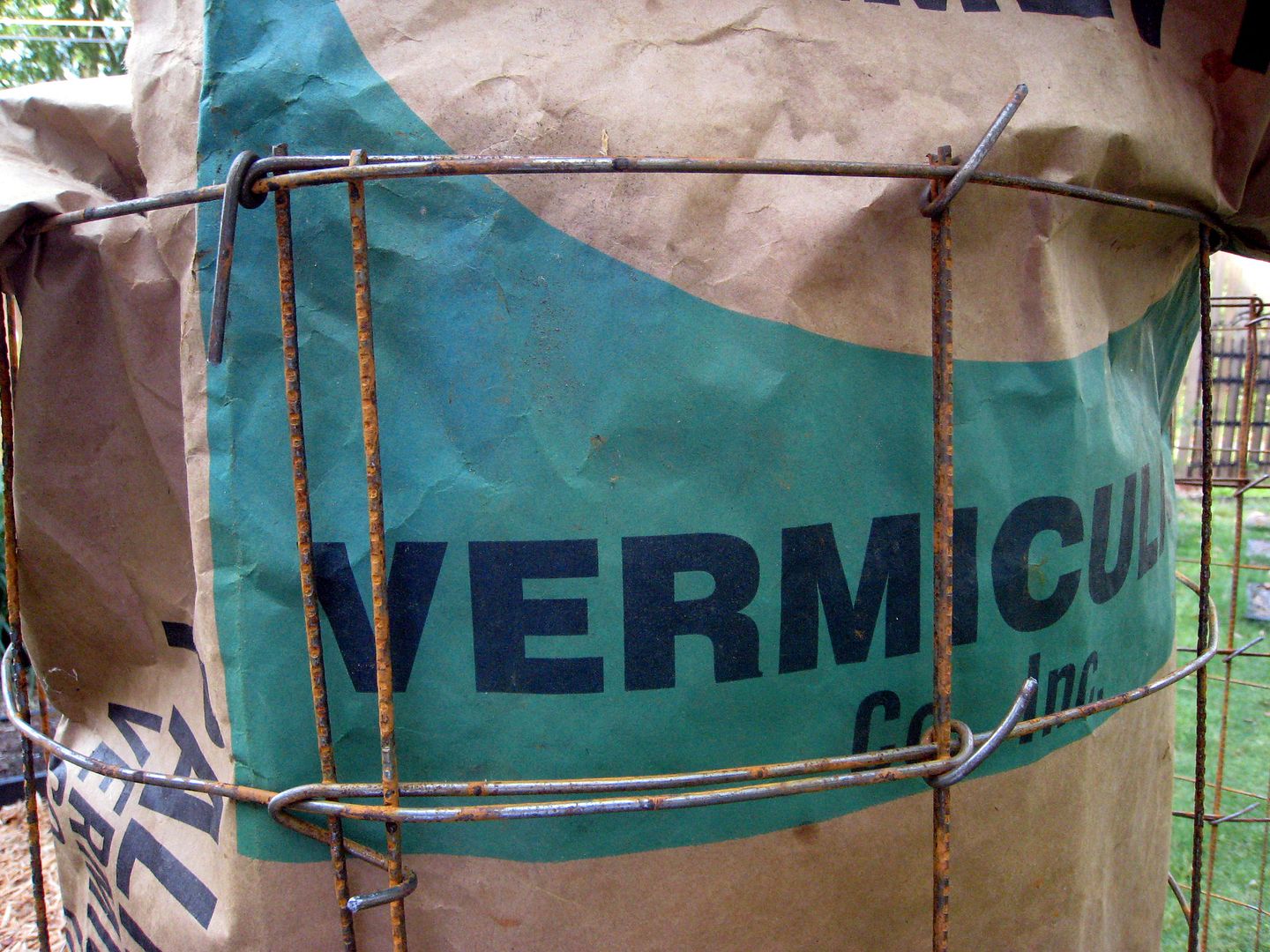

Here you are Fritz-
(I had to put an empty vermiculite back behind the wire to get a good focus on the close up.)
The top of the cage at the overlap section where the "connections" are with close up shots of each "bend":
It is a pain but after a while you get a system figured out- I generally used my gloved palm to do 75% of the end then a stout pair of flat nose pliers to finish and put the curl on the end.
After I make all the cages I cut the bottom circular wire off so that about 6" of the wire will stick into the soil for stability.
Using 12 full squares with the single overlap gives around a 22" diameter if I remember correctly. This is wide enough for the bushy determinate types like the Romas but still allows for 2 rows to fit inside a 4' wide raised bed with a couple inches spacing to spare. (This allows for a little more air circulation too.)
At my local building supply store the cose for a 150' roll of 5' re-wire runs a tad over $90.  This is up about $8 from past year.  Last year the same cost something like $120 at Home Depot, no telling this year....
The "yield" from one roll is calculated as 23-
150 ft x 2 squares / ft = 300 squares long
300 squares / 13 squares per cage = 23 cages  (12 full squares + 1/2 on either side for bending
Cost per cage = $95 / 23 cages = $7.30 per cage.
Yeah the cost is a little more than the nicest cage you can find in the store BUT these actually work- the plants generally don't outgrow them, they don't get tippy and fall over and the openings are a comfortable 6"x6" to reach in and pick the fruits of your labor.
Plus, these will outlast me I am certain.
I'll end up with around 41 or 42 total tomato cages from the two rolls I've purchased.  I'll end up with less since
1. I am going to extend two by another 2 1/2' for the Tommy-Toes mega-vining cherry tomatoes.  In effect I'll add another 1/2 cage on top of the existing ones.
2. I'm going to use some of this wire to make pepper cages after I study the idea a bit more and I plan on leaving a little in reserve for future projects.
