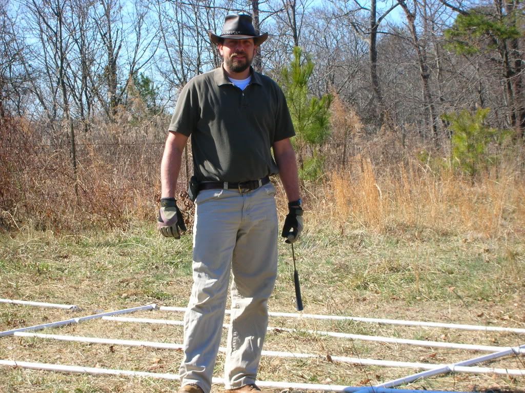

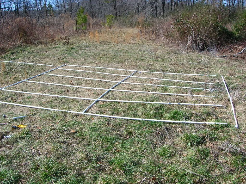

This is the top frame laid out.  It's easier to go ahead and glue the top peices to the bottom side rails.  Let the PVC cement cure for a few hours(about 3).
The PVC greenhouse master...well in my mind anyway....

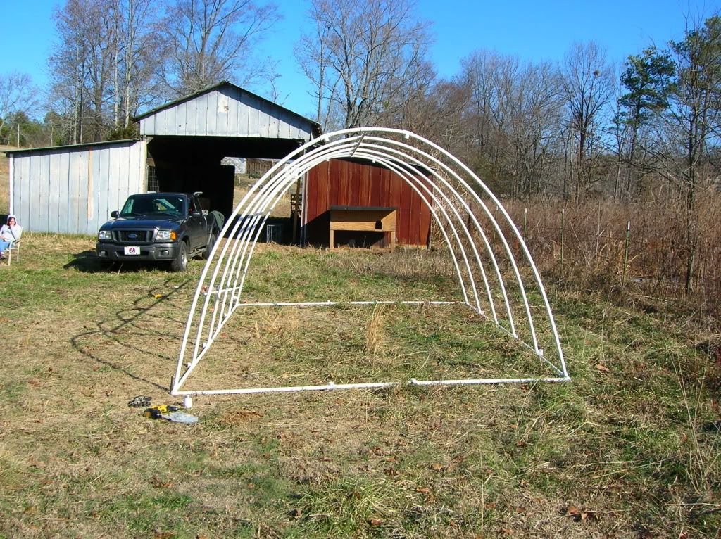

Finished product..see my wife in the upper left corner…that was her giving me moral support while reading a good book…

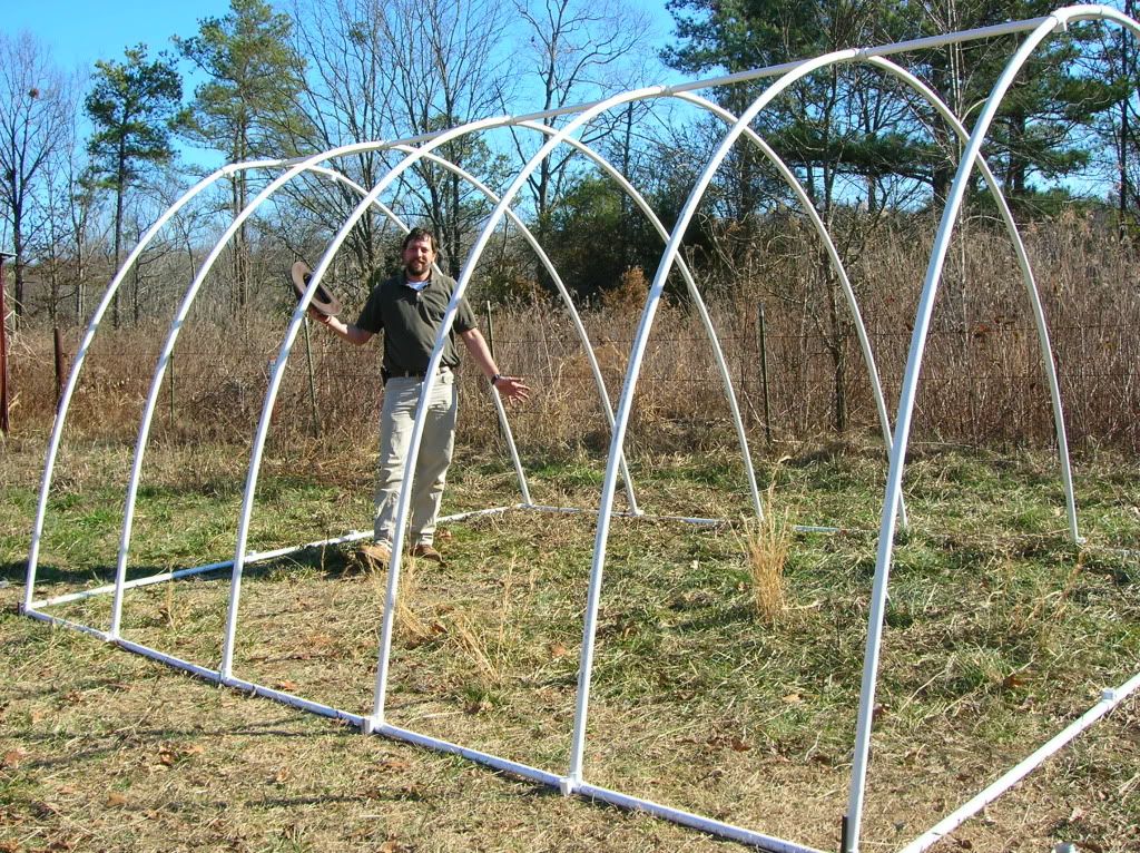

Walls raised.

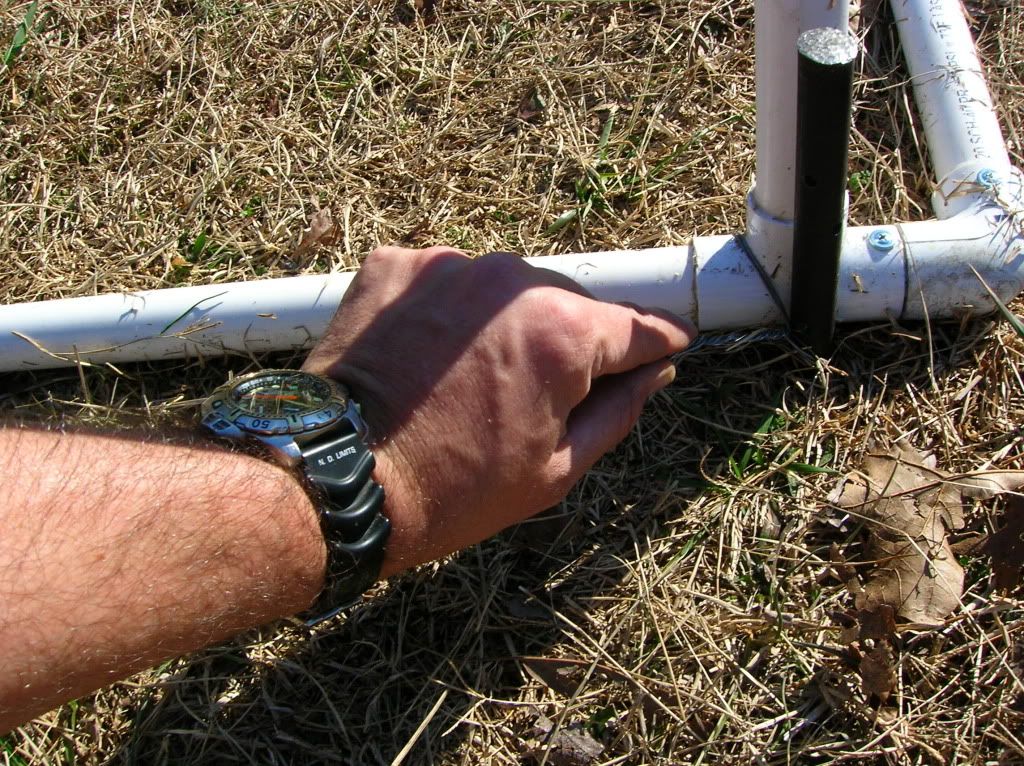

I used 24" metal stakes to secure the greenhouse.  It also prevents the sides from bowing out due to the pressure of the pvc from pushing outwards because of the bow.  I then wired the greenhouse to the stakes to prevent the wind from lifting it up.  I found some stakes with pre drilled holes in them for the wire to go through at Home Depot.

looks, great, looks like it has a lot of slant to the top, which is good, not sure where you are located, but a word to the wise, I had a buddy build a frame like this as a cheap carport for his truck, we got an 8 inch snow and it collapsed and the PVC dented his cab.
  but I'm not sure, if you leave the plastic on it year round or not.
