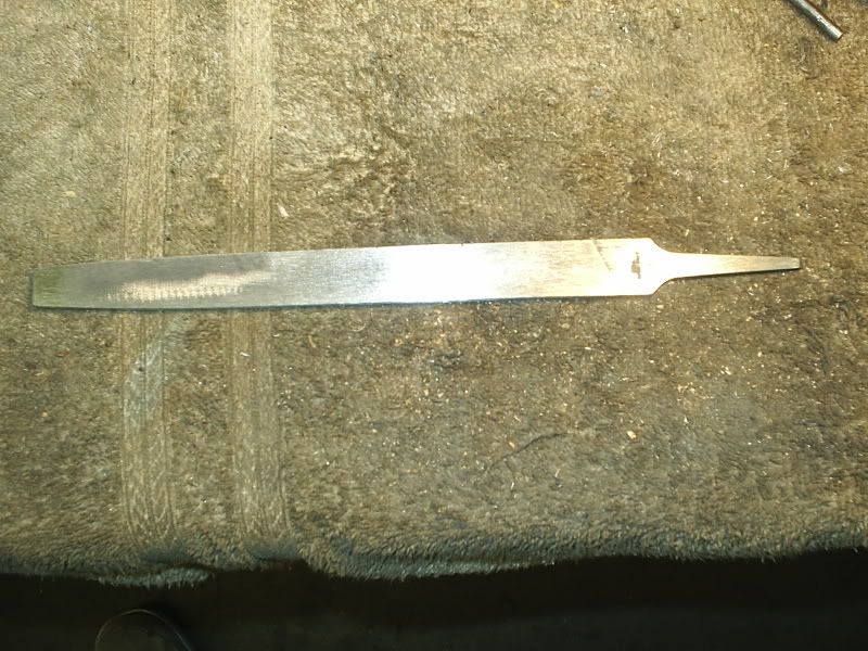

In my downtime at the gunshop, I have been making strikers to teach flint and steel to a group of boy scouts.  I picked up some trashed bastard files from local pawn shops on the cheap. A 3 ΒΌ inch chunk of a 12 inch file make a pretty good little striker once the edge is ground down.  I also had in the stack a few 10 inch bastards as well.  They work fine, but the heft is just not as good as far as I figure.
I set to annealing the file and working it.

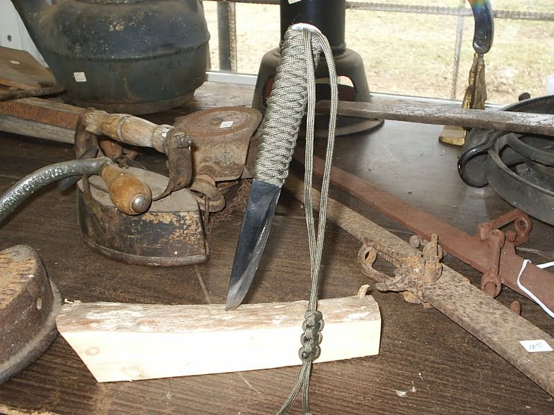

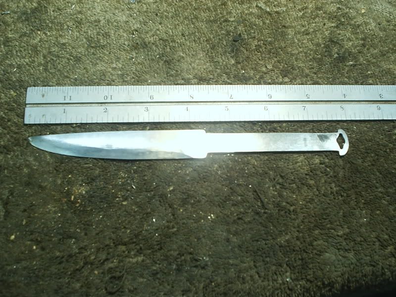

The Blade shape came easily, but I really just could not figure out how I was going to do the handle.  Lack of skill and experience lead me to what I have done before.  I paracord handle.  I marked out the dept of the slots on the tang and when after it with a hack way and grinder.

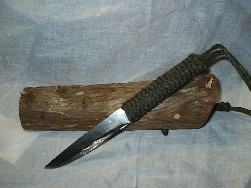

I made some significant flaws with the grinder, butting a good sized divot on each side.  It clean up nice when the metal was still soft, but one I heat treated the steal, it was rather glaring again.

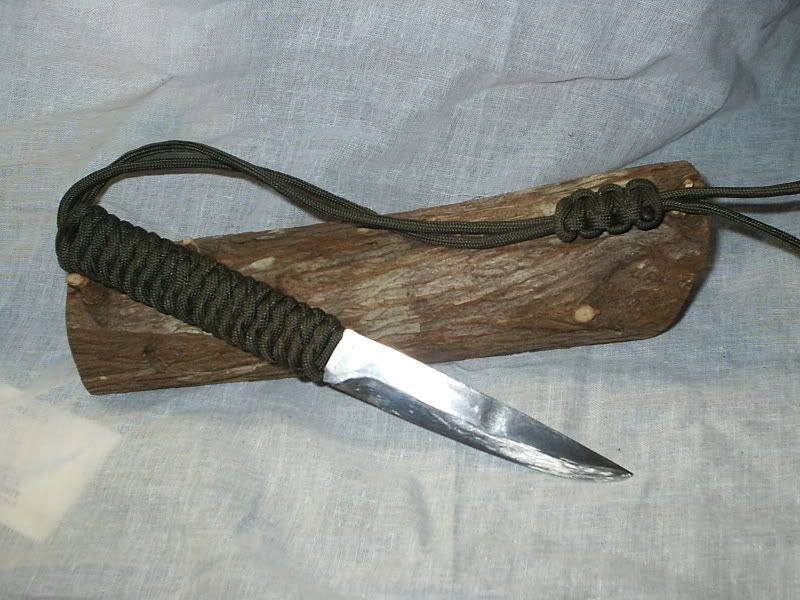

I chose a scandi grind to emulate the one that my friend had make (in turn inspired by a Mora) and it is likely the simplest geometry to start with given my experience level.
I had intended to go with a different wrap with the paracord, but when I noticed my mistake I found that I like the pattern that I was using much better.  The tails of the paracord are joined buy cobra stitch brad about six links long that will hold its place or slide to be adjusted easily. The ends are simple overhand knots, but I may change that to something fancier
