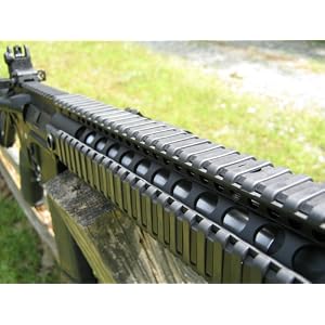

I decided to put a quad rail on one of my rifles and went with what appears to be an identically constructed rail for $38:
http://www.amazon.com/gp/product/B005QPJOSS/ref=oh_details_o03_s00_i00
Only kicker is that it comes with those 12 rubber covers, which are nice (at the 3,6,9 o'clock positions) for the fingers if you're not putting a vertical grip on your rail. Not sure if that's worth the extra 8 bucks to you or not. It had 5 stars with 66 reviews... it's pretty solid so far (but I haven't installed yet).
