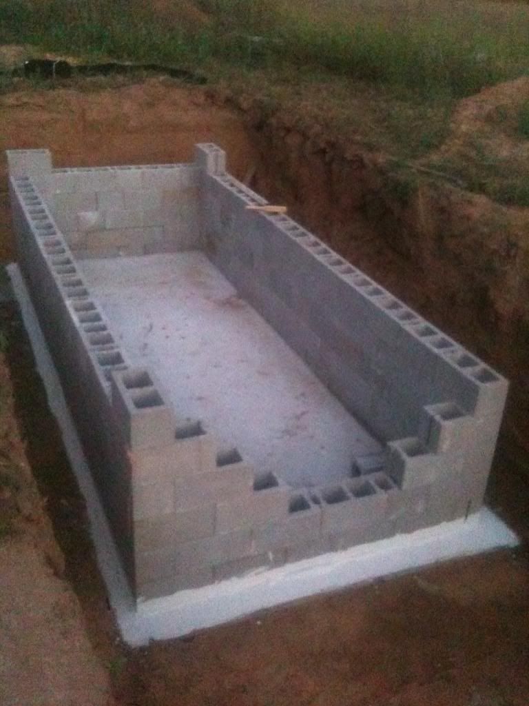

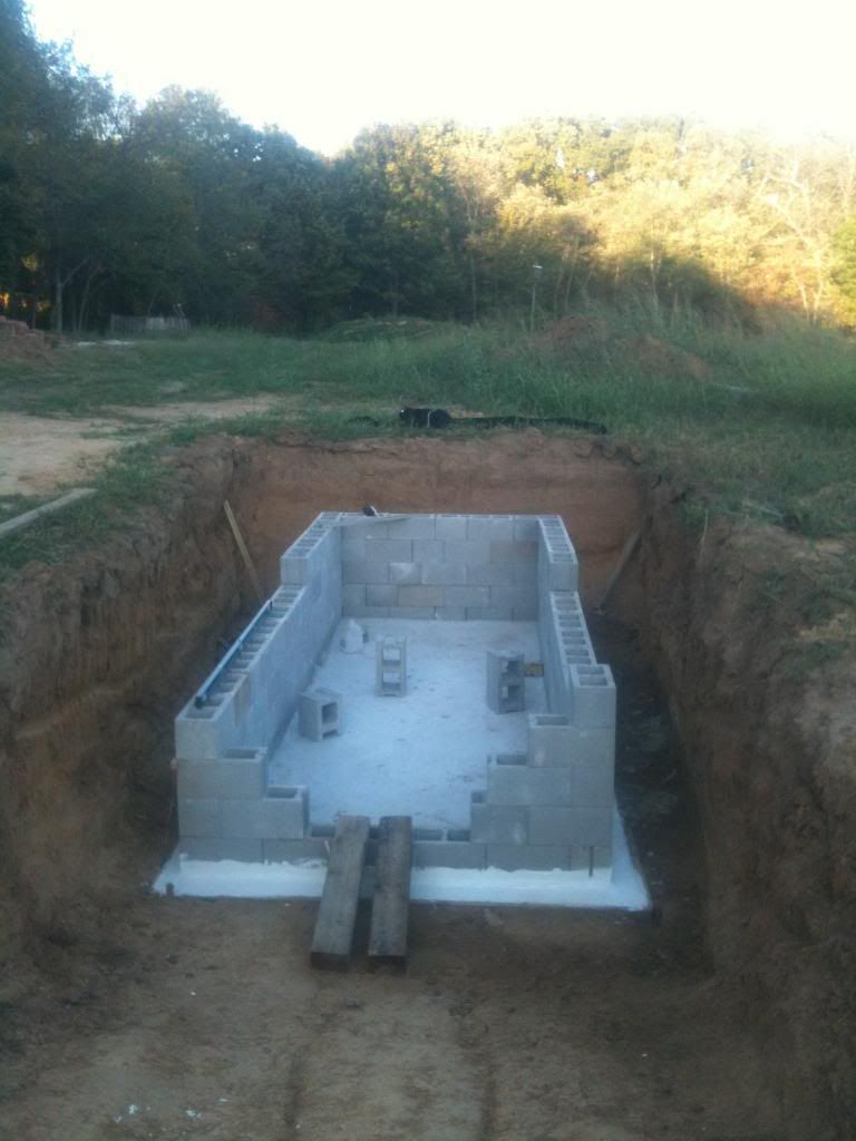

Notice that I have rebar sticking out from a few blocks. I poured concrete columns in 10 of the blocks throughout the perimeter.

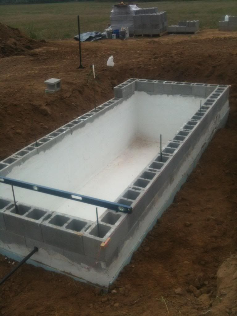

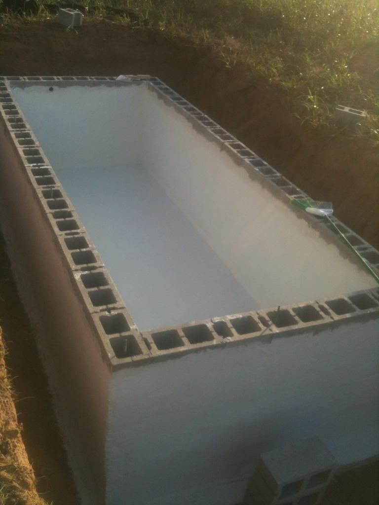

And here we have most of the stacking done. After stacking 6 high, I applied a product called Quikwall (a mortar with fiberglass strands) to the inside and out followed by two coats of Drylok. Apparently Quikwall is very water resistant too, so with the addition of the Drylok I feel confident that things will stay dry.

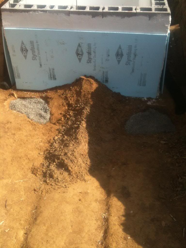

Once the Drylok cured I ran a drain tile from the rear of the basement to the front on a grade so that water would migrate to 2 four-foot deep holes which were filled with gravel. Next, I layed 1" blueboard all the way around the perimeter and backfilled part way.
