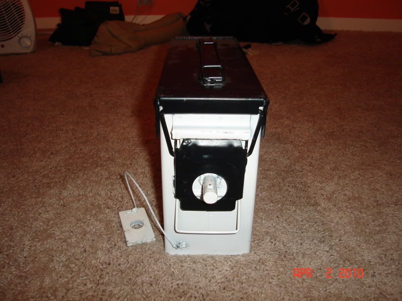

Here is what I do:

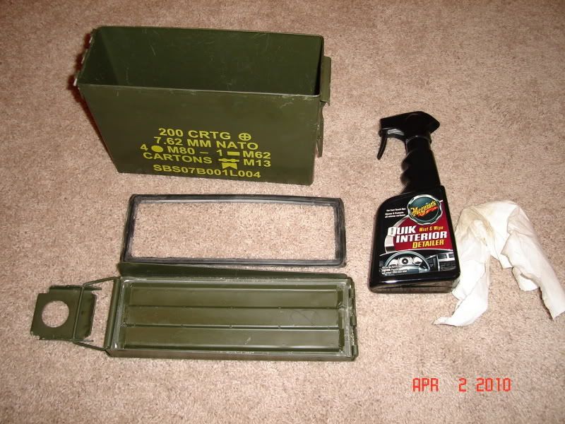

I use 30 cal ammo cans. I use them because of cost and durability.  The local Army surplus store charges $2.50 for a 30 and $4.50 for a 50.  I wish they didn't close Dec 23rd - May 1st.
I take them apart and clean them up.
I weld a stud on it that has a hole drilled through it.  This will let me lock them and it is still water and air tight. I use the longest grade 5 1/2 inch bolt that I can find, cut it up, drill a hole through it and weld it on.  The plates are to help keep the box from openning. It is a hell of a lot cheaper then the lock kits too.  I then prime and paint them.  I don't have many calibers so color coding is working so far.

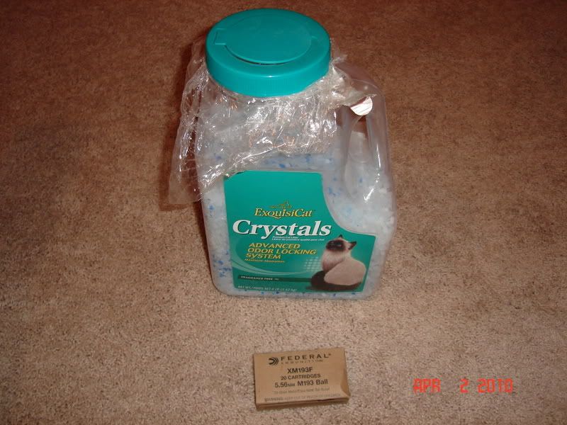

I make my own desiccant packs.  I use kitty crystals. http://www.petsmart.com/product/index.jsp?productId=2750938  The kitty crystals are a little expensive but I don't think I will ever need to buy more.  I fill a Federal 5.56 box with the crystals.  I glue the box back shut with wood glue.  I use a utility knife and cut slits in the box.  I like these because I can throw them in the oven at 220 for an hour or so to dry them off.  I throw a layer of foil over them to keep the direct heat off.

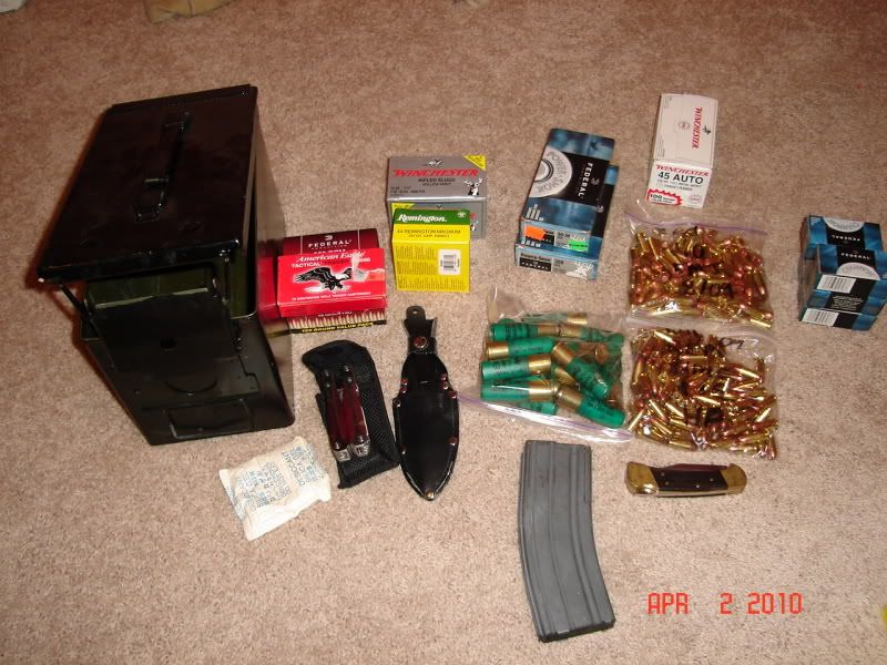

Finally I have a bug out case.  It has ammo for each gun. If I grab it I can grab any gun and be able to shoot it.
It comes in at 32.4 pounds.
My goal is 1000 rounds of each in long term storage. I always have more but that is the min.
