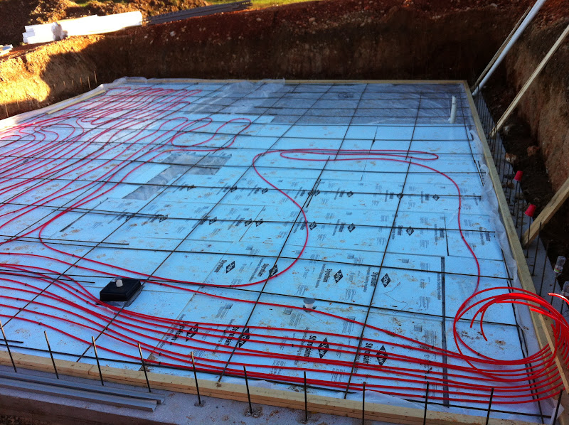

I should explain one more detail I have not gone into yet. The water that will move through the boiler system is in a closed loop. None of this water will be consumed.  Everything I have read or seen so far indicated that the water loss at those temps is very low. One system I took several ideas from used less than a gallon over the whole winter.
The boiler water will run through the radiant floor to heat the house. The hot water for showers and kitchen use will be generated in a special tank that will have a water to water heat exchanger similar to the one that will be used in the Aquaponics tanks. There will be a smaller tank, size yet to be determined that will have this heat exchanger mounted inside it. The boiler water will flow through the exchanger. The consumable hot water will flow around the exchanger to heat it up and then be stored in the 180 gallon tanks. Right now I am thinking 2 of those tanks for shower water and one for the radiant floor. Those calculations will be left up to the engineer's in this project, I am mainly the fabricator and overall concept designer.

We are still in the construction phases of the house. It is so well insulated that we are heating with nothing more than a 20,000 BTU propane heater right now. We shut it off during the week and turn it on when we are there working. We are able to maintain a constant 52 degrees day and night with no supplemental heat. I ran the propane heater this weekend and we saw a temperature gain from 52 to 63 degrees in less than 12 hours. It is clear that we will be able to heat the home with nothing but hot water. If we properly manage the radiant floor going into the winter, keep it at a constant temperature, we will likely not even need the wood boiler part of this system to heat the house, only in a long period of winter weather with heavy cloud cover would we have to rely on the boiler to heat the home itself. This means all of the heat energy create with it will be available for hot water for showers, cooking, cleaning and of course the Aquaponics.
