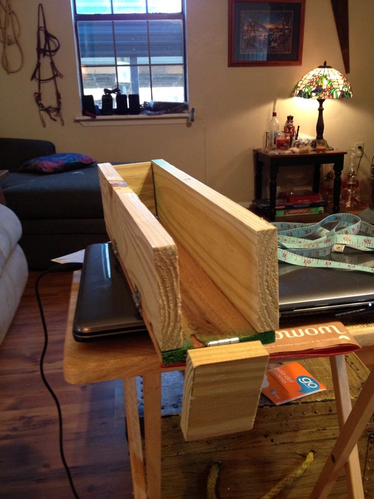

I finally made my own soap mold! I need to get tape (yes I am out of duct tape  >:( >:(
Then I will line them with poly mailing bags and some freezer paper. This weekend I am making cedarwood and tea tree soap. I have gotten a lot of compliments about my soap from people I have given them too.
Here is the math:
2.4.2013-new wood mold
2.5 x 3.5 x 15.75 = 137.81 cu inches
137.81 x .39 = 53.75 total ounces of oil or 3.36 lb of soap
36.1 tallow
17.7 coconut oil
8.241 oz lye
17.8 oz water
or
17.8 tallow, palm oil and coconut oil
8.2 oz lye
17.5 oz water
This is with 0% superfats; From here you would add 5, 10 or at the most 15% superfats
Re: 13 in 13 Skill 1: Soap Making
« Reply #36 on: February 04, 2013, 06:52:31 PM »
Oh and this wood was scrap at the home depot; .51 each, one was a 1x4x4 and one was a 1x6x4 and they cut them for me. The hinges are what costs so much

Cool mold!  I might just make one of those myself this weekend. ;)  Then all that's left is to wait on my does to freshen, as I already have plenty of lye and fats on hand.  I just love plain old fashioned lye soap made with goat milk.

Here is a photo of my soap mold lined with used poly mailer bags.
I just added my super fats to my batch of Cedarwood Tea Tree soap. Then I will cook it and add the essential oils and add it to the mold. I will add photos when I am done with that process.
