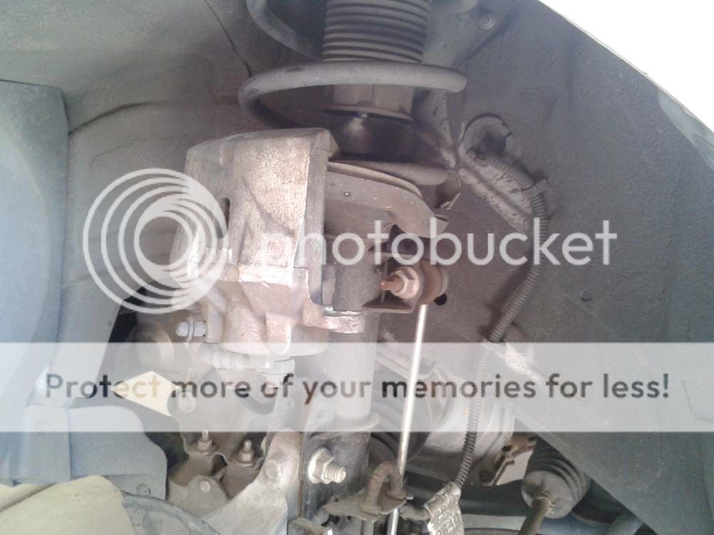

On my car there are two components that need to be removed to change brake pads and rotors. There is the caliper which holds the brake pads and the piston which attached to the caliper. Each has two bolts that need to come out. Also it helps to remove the mount that the brake line attaches to so you have more play with moving the parts around.
Here is a nifty trick when taking stuff off, put on lug back on in order to keep the rotor from flopping around and being a pain in the rear.

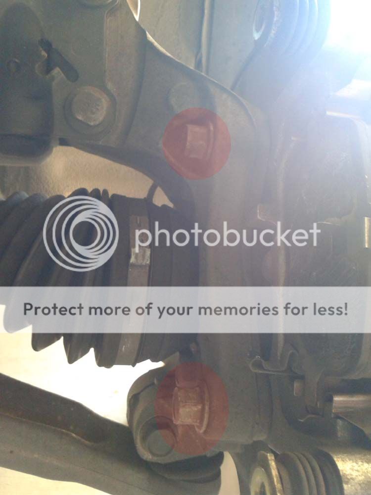

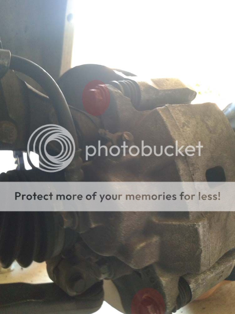

First the piston housing. The two bolts are in red. Remove those and the housing moves freely.

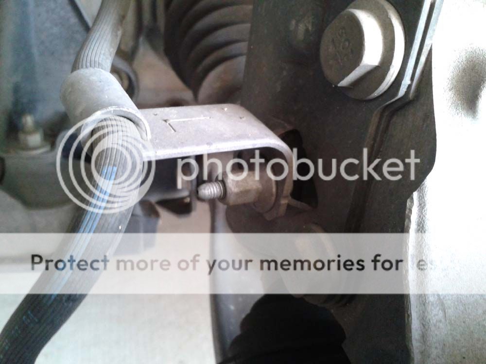

Also let’s remove the brake line mount from its position so we can move things around better.

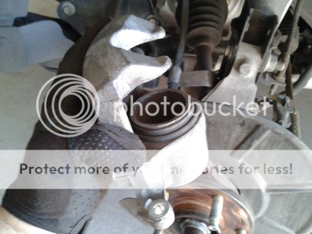

So now the piston is free. You can see that it is hollow – this piston needs to be pushed back in, we’ll do that a little later. Just a note that my rear pistons are solid and those had to be turned back in like a screw, make sure you know how yours go in so you don’t damage anything.
Let’s hang the piston out of the way, the struts are a great place to do this:

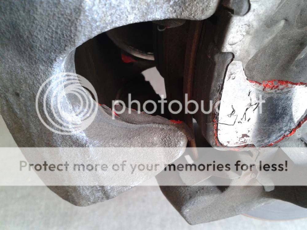

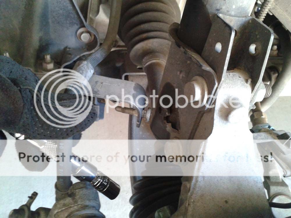

Now let’s get the caliper off. There are two bolts for those (different size from the piston on my car)

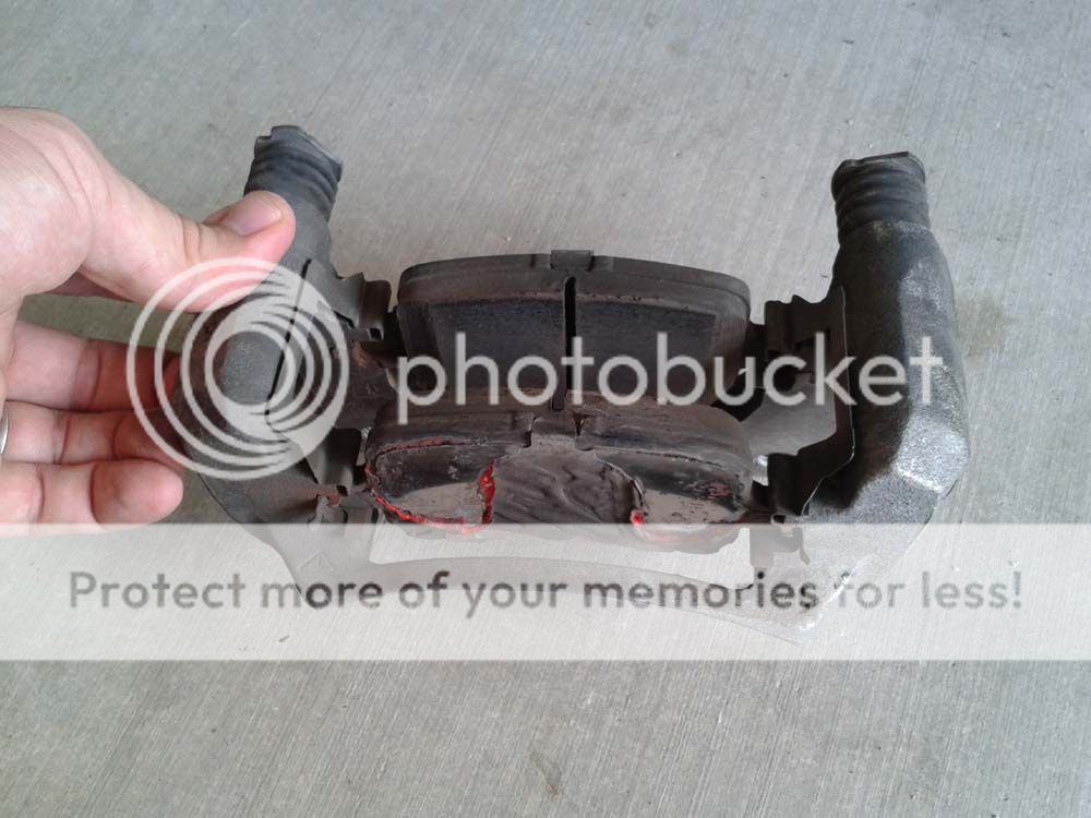

Once the bolts are removed this piece slides right off. Here is what it looks like by itself (brake pads installed)

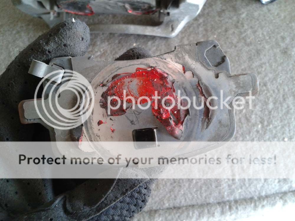

There was a ton of red grease crap all over everything. I cleaned all of that off. Also this is a great time to take a wire brush and go over the caliper, piston housing, and wheel axle and clean up everything. There is a ton of dirt and crud in there. You may want to wear a mask as you are basically brushing and blowing powdered dirt everywhere.

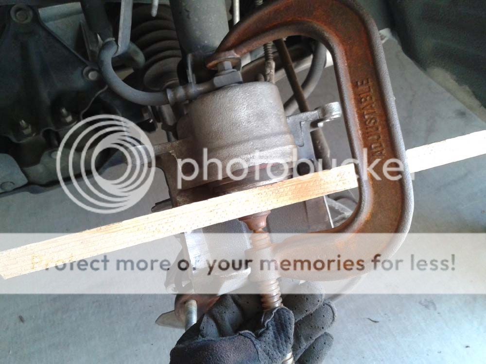

OK, now that we have the dirty stuff clean it’s time to reset the piston. The beauty of my car and cars with similar brakes is that you don’t have to bleed the lines or even open the master cylinder, as long as you do things slowly.
They make a special tool to do this next step, but why buy a tool you will probably only need a few times when you can rig one up yourself? All you need is a c-clamp big enough to span the piston and a piece of wood, I used a piece of fur stripping that I had lying around. Set it up like so and slowly compress the piston back into the housing.
Be careful of the rubber gasket that is around the piston. You don’t want to rip that. I had a section of it not seat right and bulge out on me. I was afraid of it pinching against the brake pads when I reinstalled it. All I had to do was pump the brakes to push the pistons out and the reset it again. No problem.

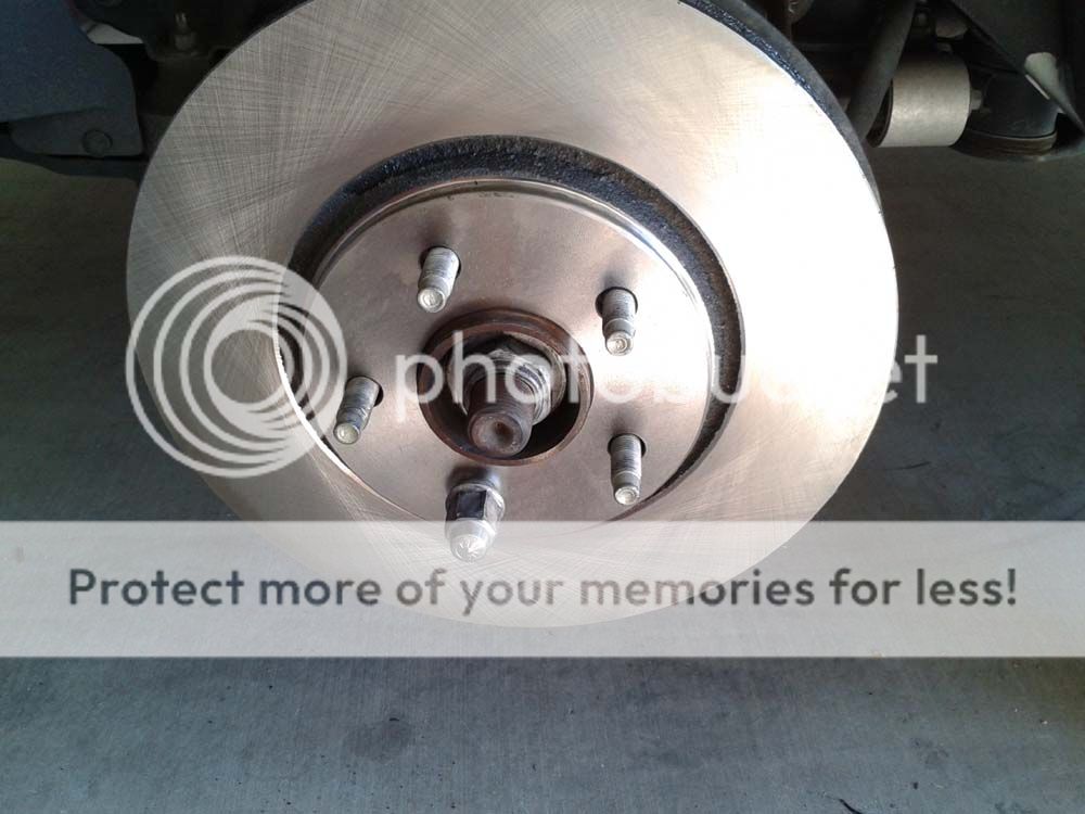

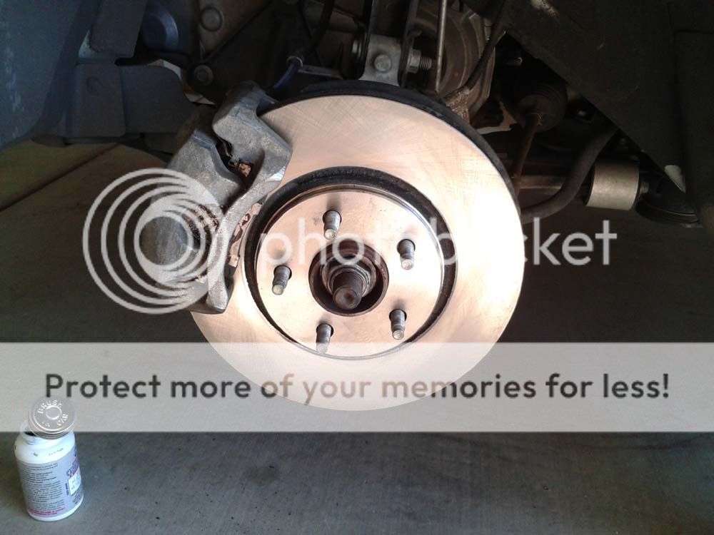

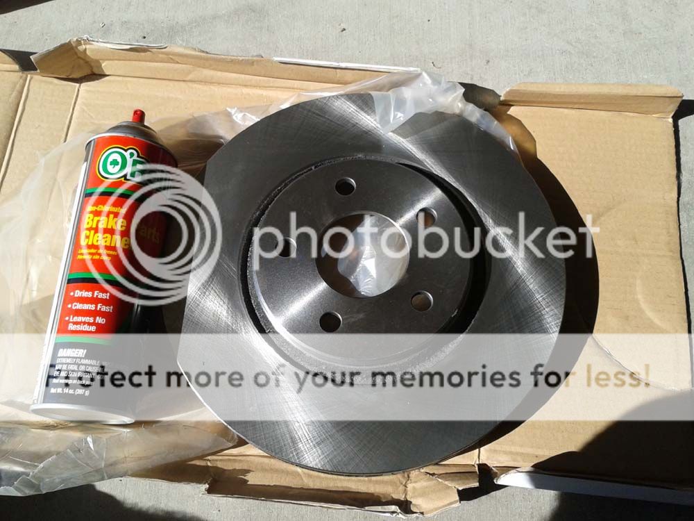

Once the pistons are reset it’s time to get the rotors on. You need to clean them as they are shipped in a protective coating of oil. If you don’t clean them I’m told that stuff will gum up on your brake pads and you’ll have a problem you don’t need on your hands.
Brake cleaner and a rag is all you need. Spray the surface that the pads will touch and wipe clean. The brake cleaner evaporates quickly so work quickly, I like to do both sides twice, alternating them front back front back.
Once clean put the rotors on the axel and use the lug nut trick I showed you earlier! It will save you a lot of cussing and headache when reinstalling everything.
Now all you have to do is reverse the process. I didn’t show pictures but make sure you grease the contacts points on the OUTSIDE of the brake pads. So basically on the inboard pad a ring/the center where the piston will touch. On the outboard grease the edges of the pad where the piston mount touches them.
Get everything put back together then hop in the car. Slowly pump the brakes several times. This will push the pistons back out and allow them to operate the brakes. You’ll feel them tense up after a few pumps. Again, do this slowly, I’ve heard if you jam them to the floor you could cause a spike in pressure and hurt the master cylinder.
Once the brake pedal feels good, get the tires on, drop the car, tighten the lugs, and take it for a test drive. I do several long slow braking stops and then a few high speed stops, then as a final test I get up to about 50/60 and jam the brakes to the floor. If you aren’t dead then you did a good job.
