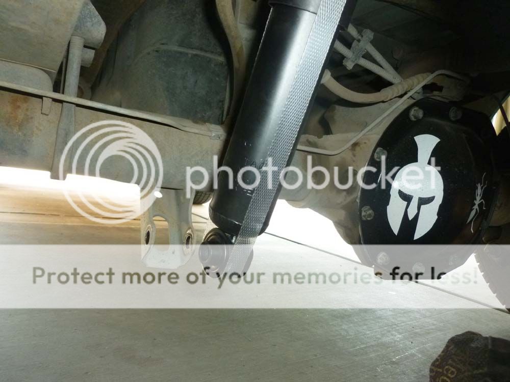

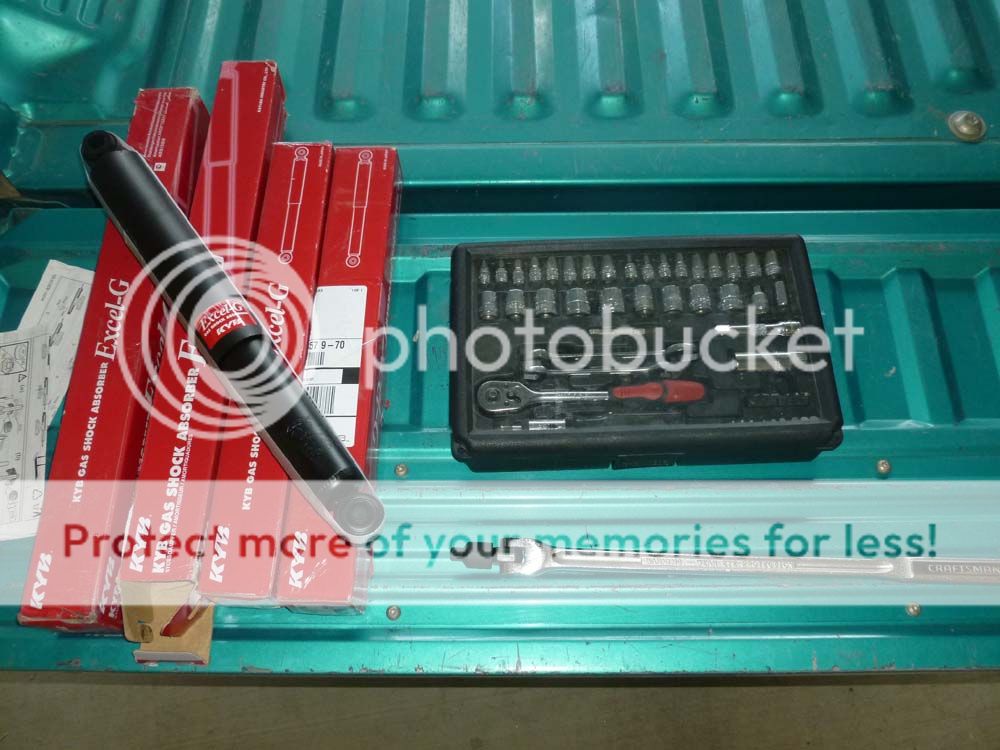

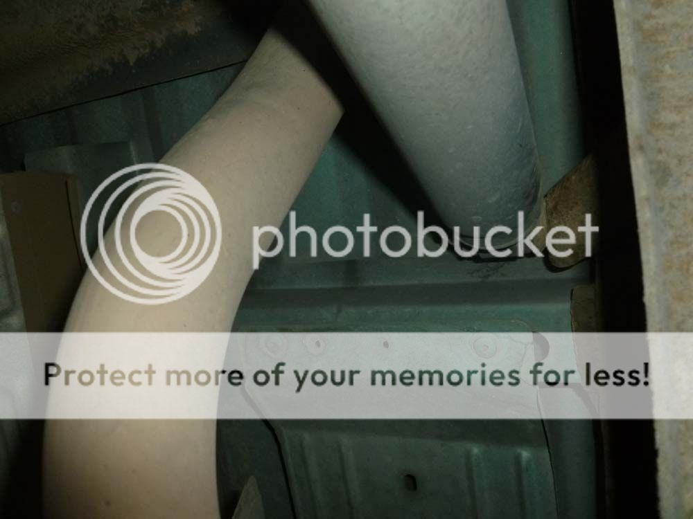

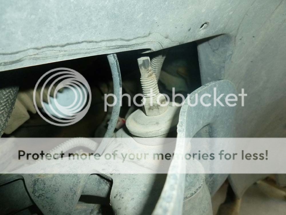

Got the shocks done on the truck the other day. Man does it ride nice! I can go over speed bumps without feeling like I’m in a low rider. The old shocks were squeaking/creaking really bad too so it’s nice to not have to listen to that.
This was a really simple job. The back shocks were more of a pain just because of space, the front shocks were a breeze.
Here’s what we’ll be working with:
I ended up needing some end wrenches for the front shocks that aren’t pictured. And I will say if you don’t own a breaker bar yet you need to get one. It’s probably been the best tool purchase I’ve ever made.

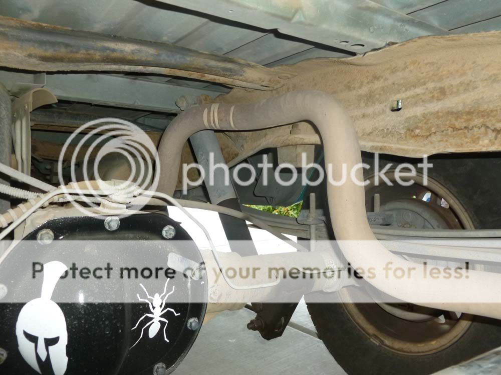

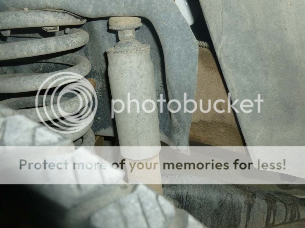

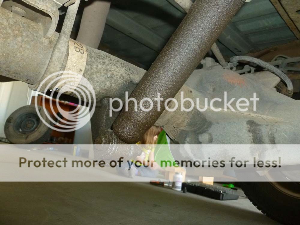

I did the rears first. Here’s a picture of one to give you an idea of location… right behind my spare:
I could have done this without dropping the spare, but I didn’t feel like cramping my space even more. You can see with the spare out that I have a lot more room to work with:
Here’s the passenger side:

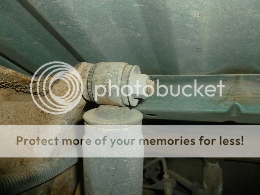

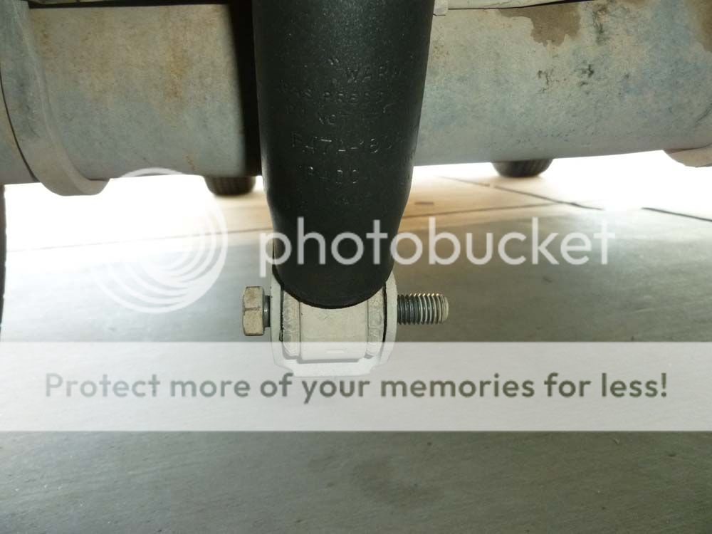

Let’s get them out! There are only two things to loosen. A bolt and nut on the bottom and a nut on the top. Here’s a close up of the bottom, you will need something to hold the nut/bolt stationary while you loosen the other:
You may need to LIGHTLY hammer the bolt out if it doesn’t come out freely. Next is the top. Remove the nut and if needed, LIGHTLY hammer off the old shock. You don’t want to mess up the threading on this as it’s attached to the frame.

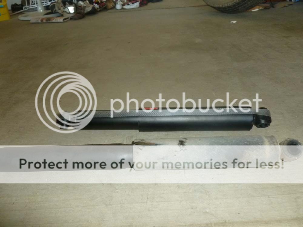

Old shock next to the new one:

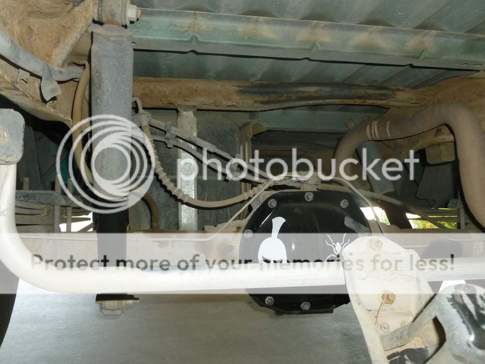

Leave the plastic around the shock for now, it keeps it compressed for you. Install the shock on the top mount and put the nut back on, but don’t tighten it. Then pull/cut the plastic off and line up the bottom of the shock with the holes, install the bolt. If you miss don’t worry, it’s easy enough to push it back in a little so you can line up the holes:

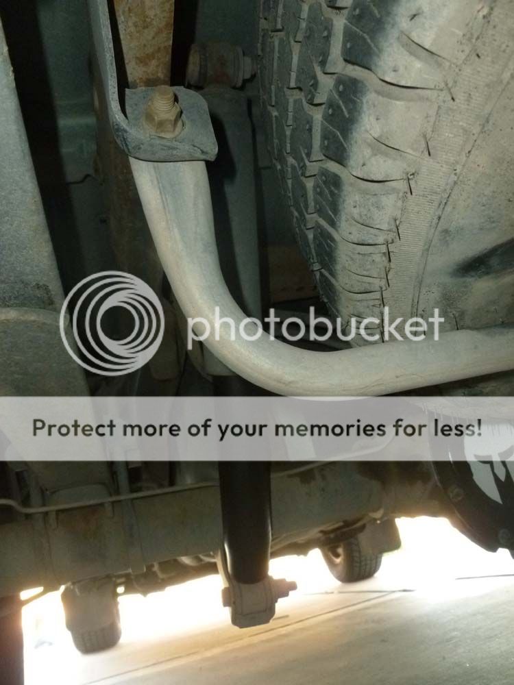

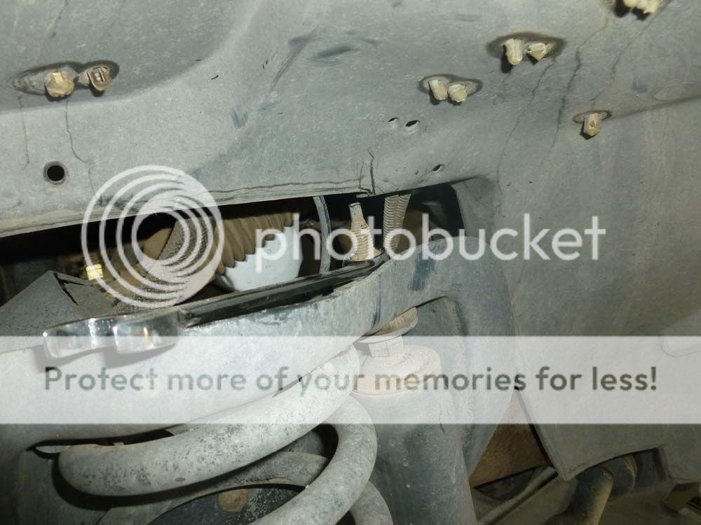

Driver’s side done, onto the passenger side. This shock was useless, as you can see by all of the grime stuck to what I am assuming was the leaking gas from inside of it. (note my daughter ‘helping’ me in the background making a house from scrap wood :) ):
The top bolt was a pain to get to since my muffler was in the way. Good thing I had extension bars, otherwise this bolt would have ruined the repair.

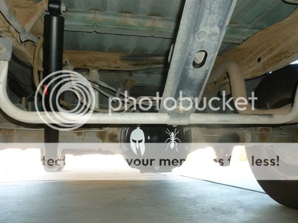

And here’s an after picture with both rear shocks installed:

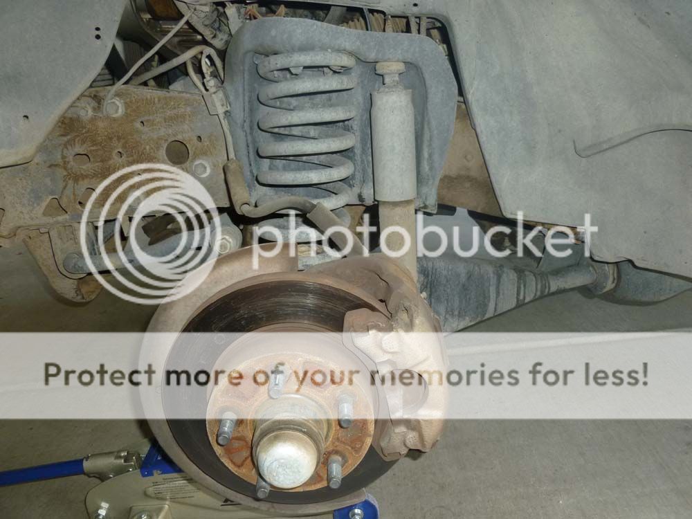

Time for the front. Here’s a picture of it:

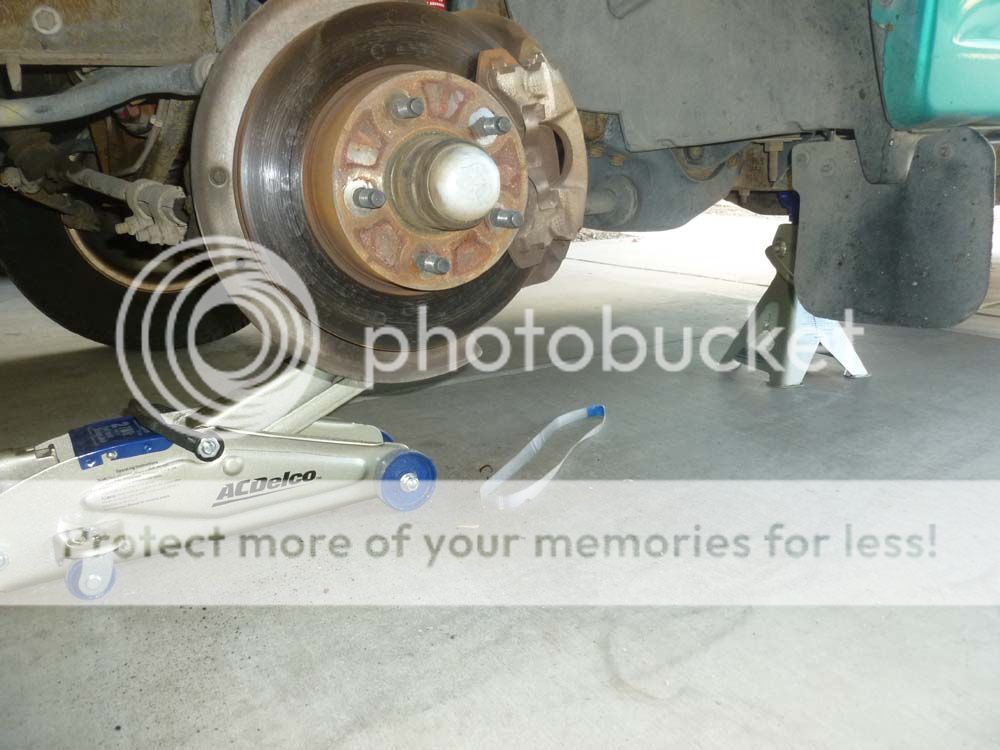

As you can see the tire is in the way, guess that needs to come off. Once it was removed I had a much better space to work with:

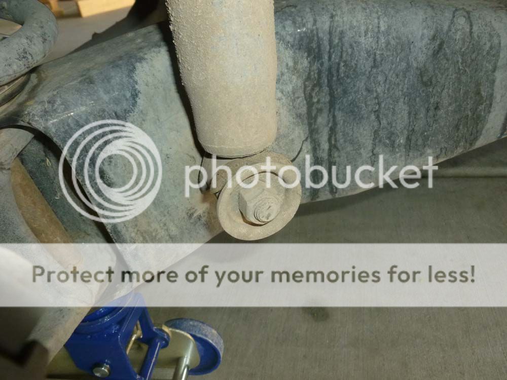

Just to show, I have to put the jack on the axle under the spring, but I made sure to have a car jack under the frame. Never get under your vehicle with just a jack holding it up:

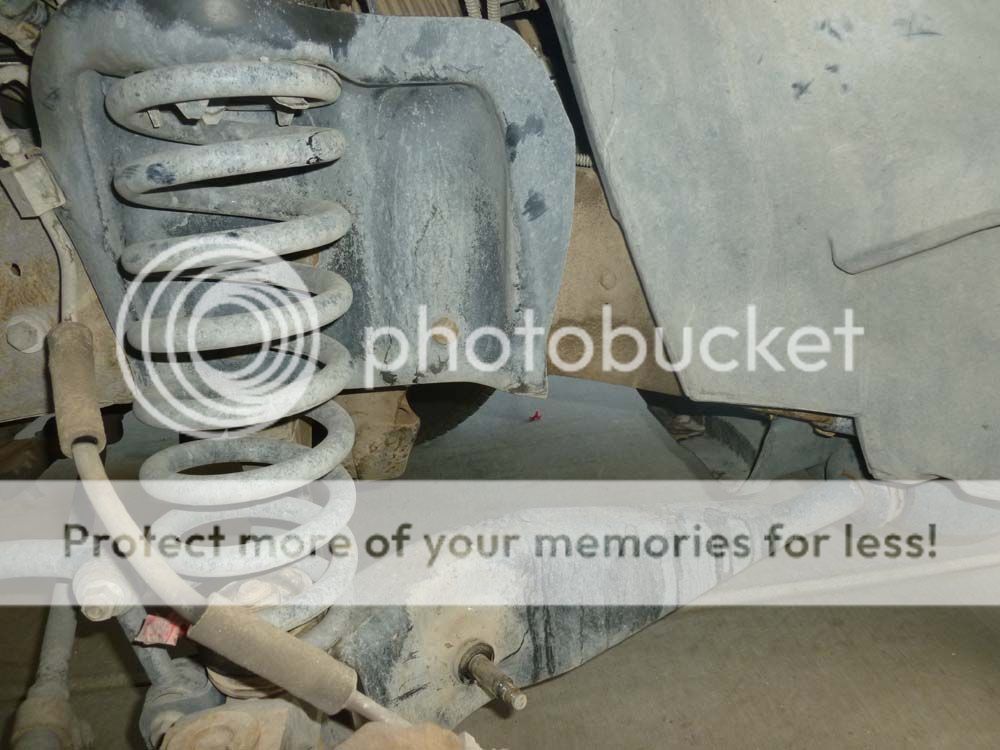

Back to work – the bottom nut on the shock is straightforward, take it off, but leave the shock on the bracket:
The reason for leaving the shock on was that you have to rotate it to remove the top nuts. If it’s off the lower bracket it wiggles around a lot and makes things more difficult than they need to be. As you can see it’s a bit of a tight work space, and I don’t have deep sockets to jam on there:
Problem solved, wrench on the top to hold it stationary, and another wrench on the nut below the bracket to remove the shock:
And the shock is out:

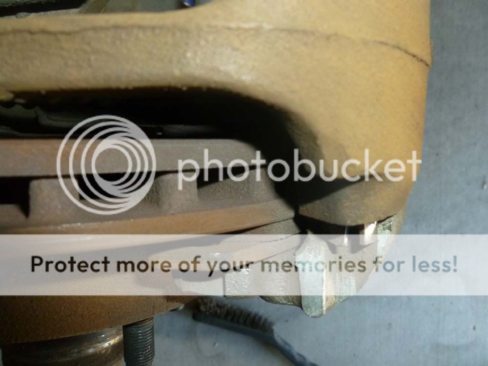

Also while I had the wheel off I inspected the brake pads and rotors, since I know how to do that now. Those brake jobs a couple months ago paid off! The pads look great, and while this picture is a bad one, I realized there is actually a window in the calipers off to the side so you can see the rear pad as well:
Put the new shock on and everything is good to go. The shop wanted around $300 to do all four, I did them for just under $100.

« Reply #144 on: December 25, 2013, 06:01:32 PM »
for my next repair...

ok guys, need some diagnosis help here for both vehicles.
malibu - i am hearing a popping noise from my driver side front wheel. it happens when i turn the wheel (more so when i turn to the right) and also when i am going over a bumpy road, then the popping noise turns into more of a rattle. if i'm cruising straight on the freeway no issues at all. the malibu forum has been a [mostly] dead end so i wondered if anyone here had thoughts. i think my struts are still good, i hear the 'whoosh' sound when i go over a speed bump and my car isn't rocking.
it's been suggested that it may be the cv boot, ball joint, or wheel bearings. the cv boot looks good and the rubber is intact. i haven't checked the ball joint out but i will tomorrow, and i'll also take a swing at inspecting the bearings. any other thoughts on what the issue might be? i know it's hard to armchair diagnose this stuff but it is worth a shot.
ranger - i have a metalish grinding/groaning noise coming from the front (i think drivers side) when i reverse and turn. going forward and turning, no noise. turning the wheels left or right all the way while still, no noise. it only seems to happen when i reverse and turn, or if i go over a speed bump.
the ranger forum has been a little better and seems to be pointing to ball joint or brake pads/rotors (i don't think it is those). i'll check the ball joints tomorrow hopefully and figure this out, but again if anyone has any thoughts or suggestions i'm open to them. i really want to get both of these noises solved.

« Reply #149 on: January 07, 2014, 03:48:26 PM »
In the mailbu case, the symptoms are typical of a wheen bearing.
It has happened to me -as everyone else- but do not take my word a 100%.
I hope a more experienced member chies in.
