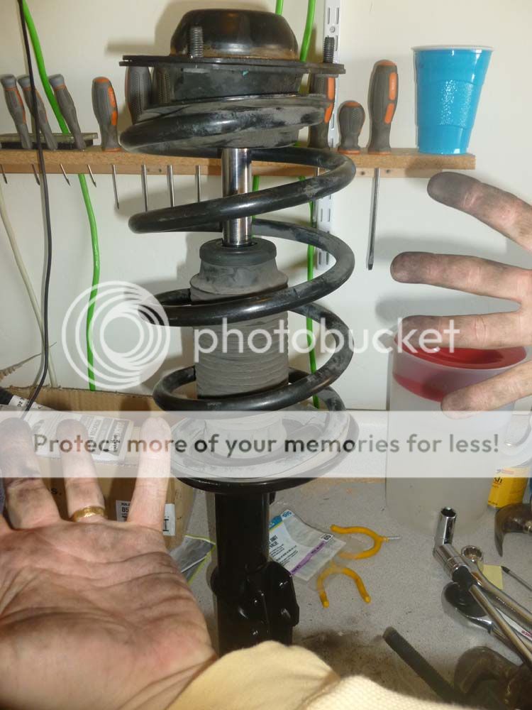

Rear shocks this time on the Malibu. These were pretty simple and similar to the front shocks on my truck. The upper mounting bracket was a little different but was still simple. Here we go, the aforementioned shock:
Upper mount:
Lower mount, which is what I removed first since I think it’s easier to start there:
Different angle and the one that I worked from:
One bolt on the lower shock mount, pretty easy to remove:
On to the top where the shock mounts into this bracket. Those two nuts come off to remove it:
…but my sockets weren’t long enough :( A good set of deep sockets and accompanying wrench is probably next on my ‘tool to buy’ list:
So I had to wrench it off which was cool, because for Christmas my dad got be a nice set of SAE and Metric Craftsman wrenches:
With the nuts off the bracket comes right off. Mine was stuck after being there for nine years so a couple good jerks and it came loose:
Old next to the new, you can see the hardware that has to transfer to the new shock:
To remove the hardware from the shock there is a nut on the top that needs to be removed:
As I took the pieces off I set them on my bench in the order that they go on so I didn’t mix any up or lose any:
As you install the bracket on the new shock try to keep it compressed, and then put the plastic strap back over the bracket, that will make it easier to handle and install:
I started the bottom bolt to hold the shock in place, then lined up the top and cut the strap off:
Let the shock expand on its own and guide the top right into place:

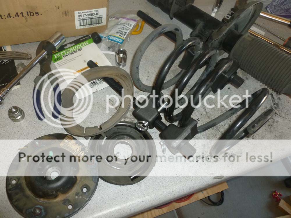

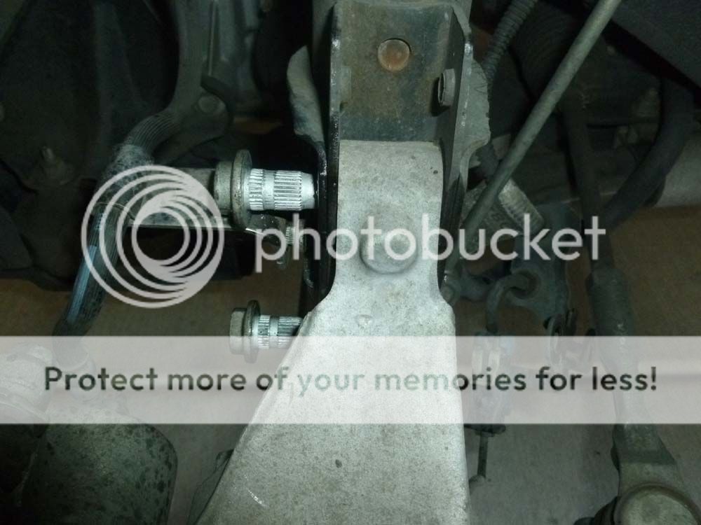

« Reply #228 on: April 03, 2014, 10:25:35 PM »
Finally have some spare time as the baby is sleeping and my wife is tinkering with her sewing machine so here comes the front strut write up.

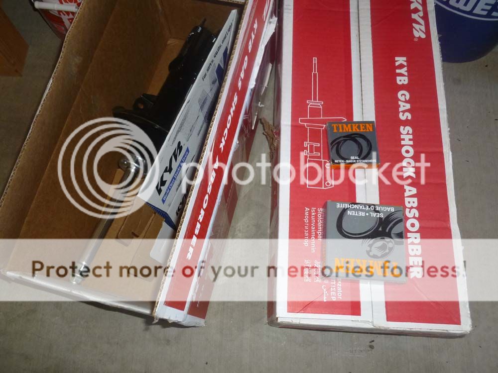

Here are the struts in need of installation:
Ignore the seals, nothing happening with them. If you listened to my interview with Jack you’ll know those are the bastards that I wasn’t able to install because life was against me (overly dramatic, I know ;) ).

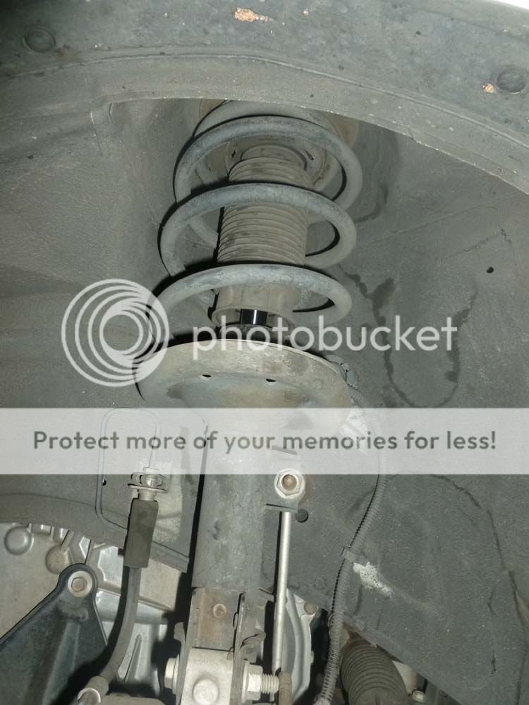

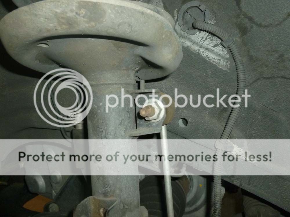

Here’s the old strut that needs to come out (ncjeeper, notice those nice, clean, wheel wells):

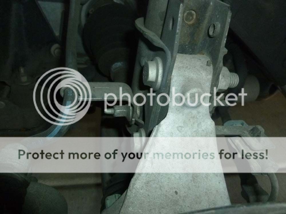

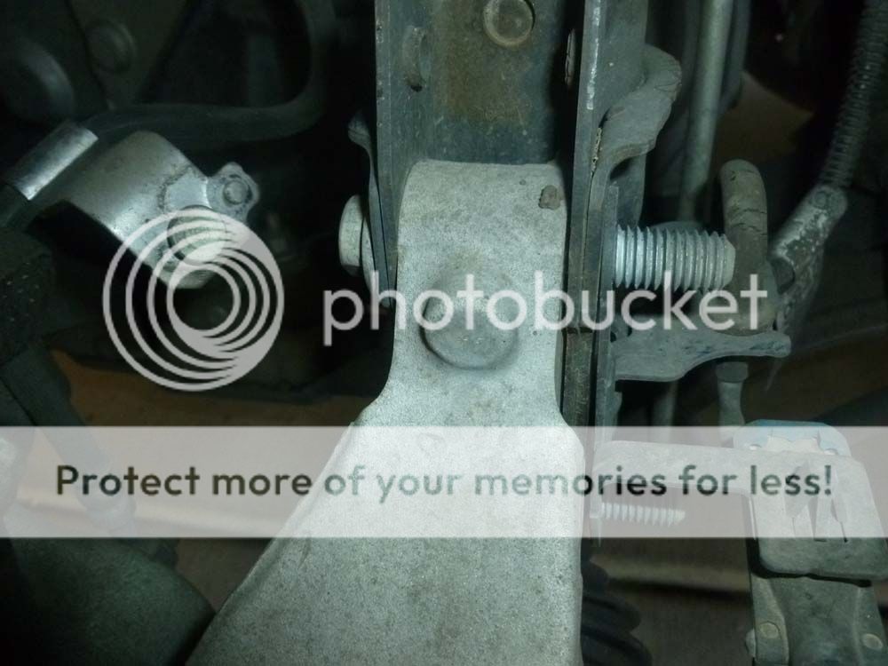

Here’s the base of the strut. The bracket holding the brake line needs to come off, as well as those two large bolts that hold the spindle to the base of the strut:
Bracket and nuts are off. I used a hammer to tap out the bolts and remove the spindle from the base of the strut:
Hammered out (mostly):

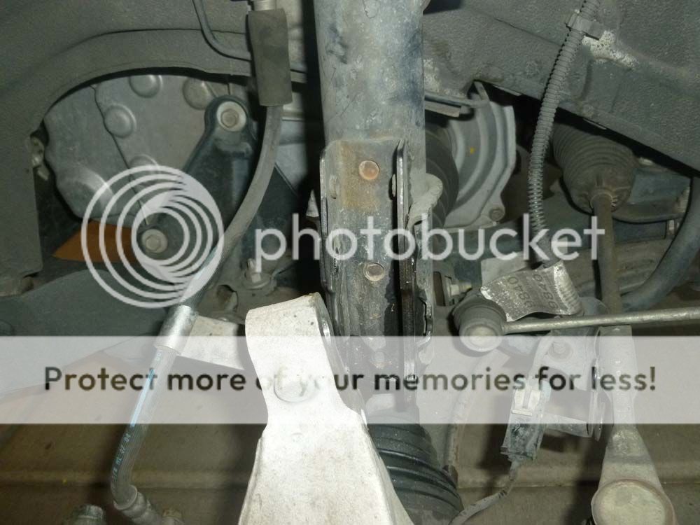

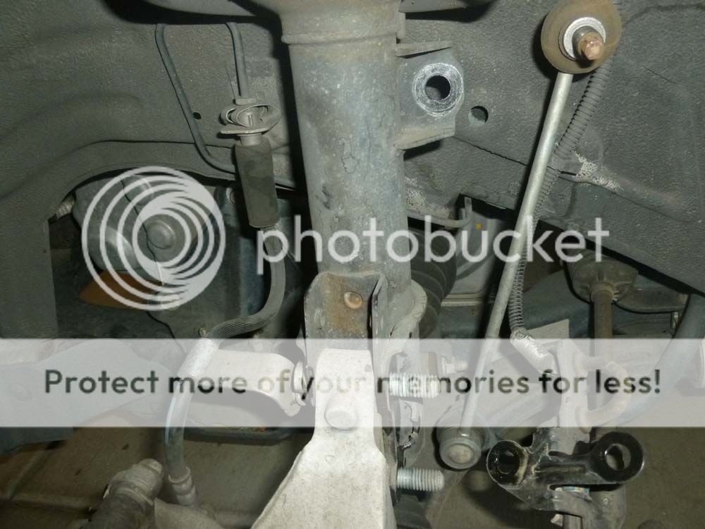

This nut comes off so the bar can be removed. I honestly have no idea what the rod is for, I think it connects to the lower control arm:
Removed:
Once everything is disconnected I pulled the spindle out of the lower strut mount:
This is where the top of the strut mounts under the hood. The three nuts need to be removed and at that point the whole assembly will be free. Note, while the strut is still mounted break that nut in the center loose, it will make life easier when disassembling the whole strut:
And the strut assembly is out. Next to the new one you can see the coil spring and top mount will transfer over to the new strut:

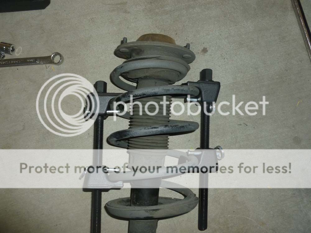

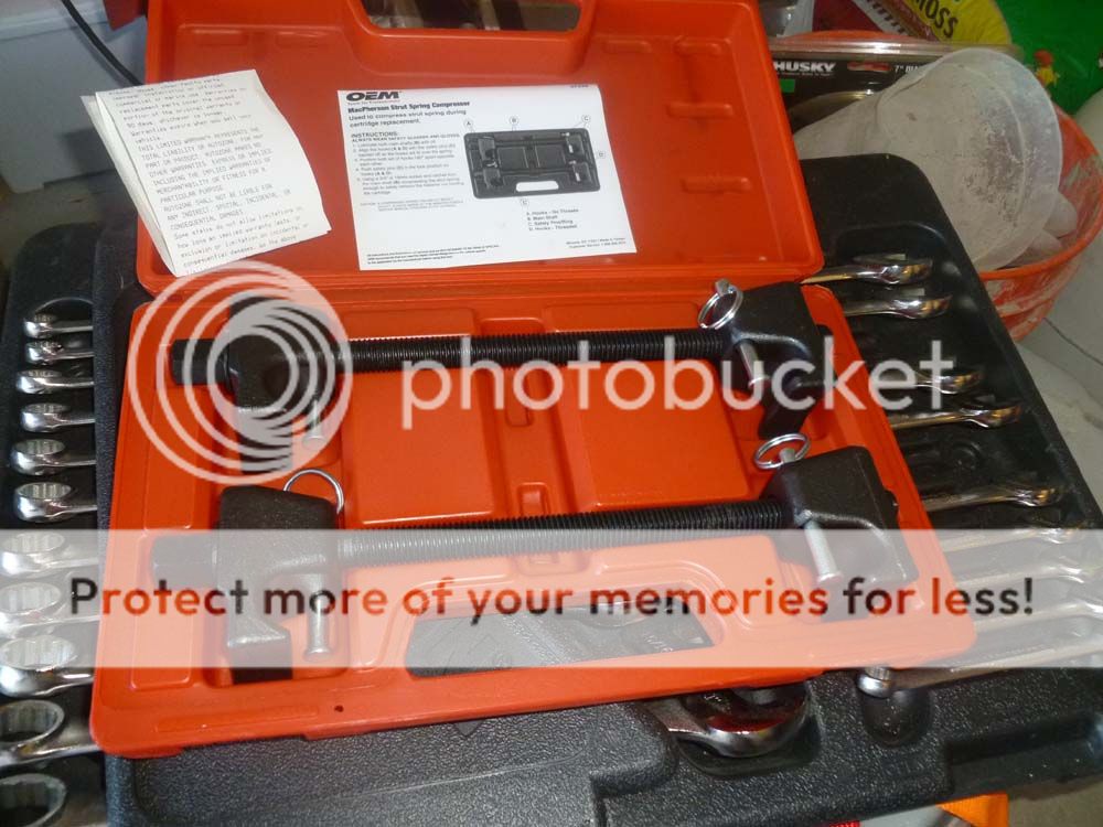

And here’s the special spring compressor tool I rented:
A note: if you need specialty tools you can rent them from almost any auto parts stores for free. Put a deposit down and get a full refund when you return it.
The compressor was really easy to use. Put one as high as you can and one as low as you can on the spring and start tightening down. Be careful and go slow and make sure the tool is securely on the spring:

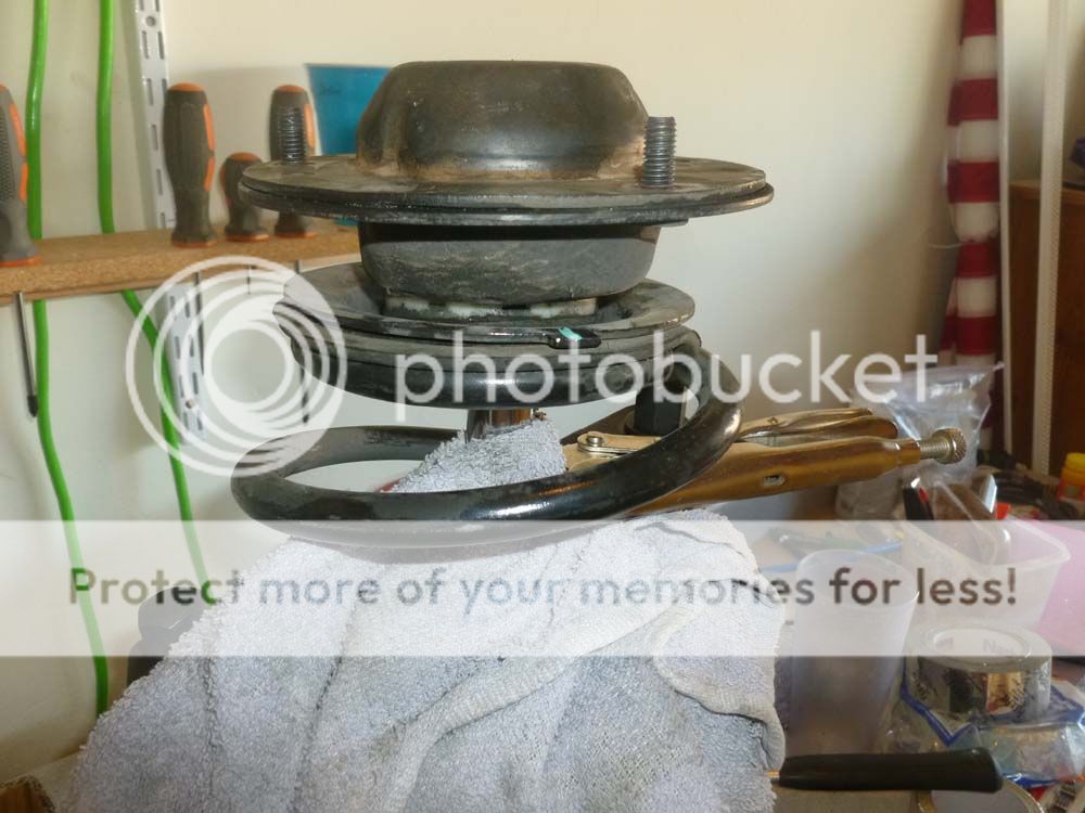

Once the spring is compressed I removed the nut that I loosened while the strut was still mounted in the car. Even with loosening it I needed a pair of locking pliers to keep the strut from turning:

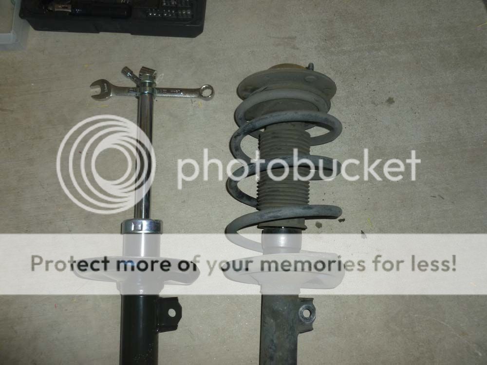

This is a hodgepodge picture of the strut assembly broken down. You can see how close the spring compressor sections are together compared to when I first started:
And the new strut is put together and ready for install! Also my dad was helping and wanted to show off his dirty hands:
