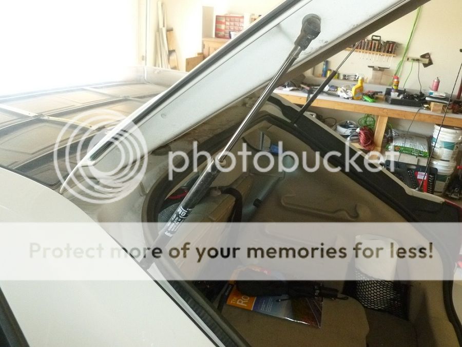

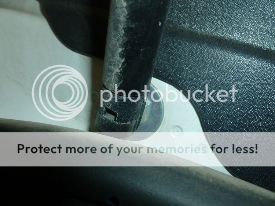

Today I’ll show you how simple it is to replace lift supports. These are the supports that your car has if you have a hatchback. The hatchback on the Malibu was getting hard to lift (although I didn’t realize how much harder it was until the new supports were installed). The old supports were making noise and squeaking so I decided it was time to replace them. Plus I didn’t want them to fail when my wife or myself was under the hatch. It’s heavy, and that would hurt.
Let’s get started! Here’s a picture of the lift supports that I replaced:

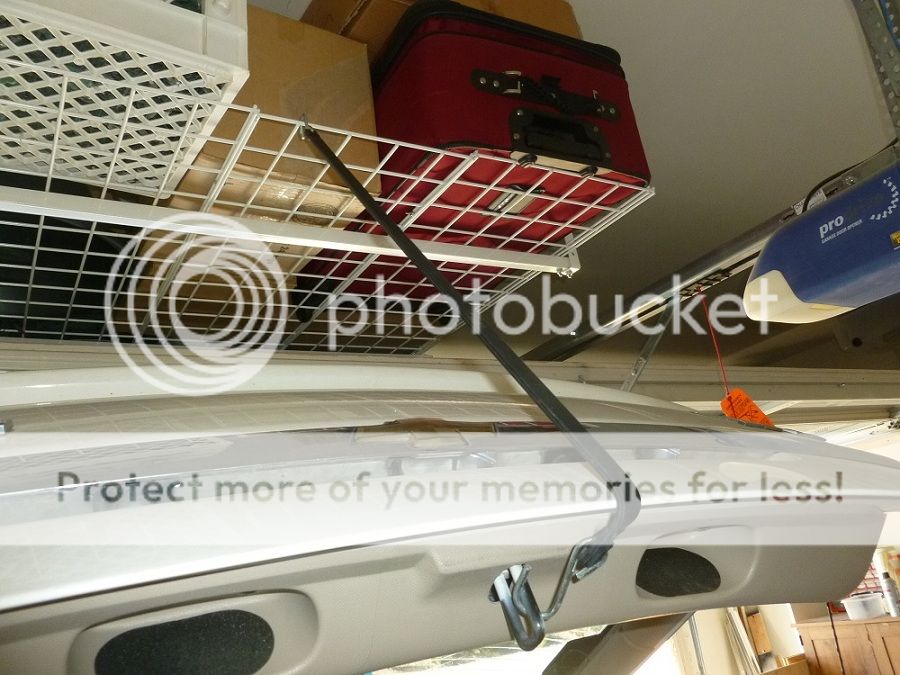

Make sure you have a way to hold up your hatch, like I said, it is heavy. With one support removed it wanted to fall, trying to do this by yourself with no support would be pretty difficult. Either have a second pair of hands or get a long pole or tie it up. I went for the tie it up method:

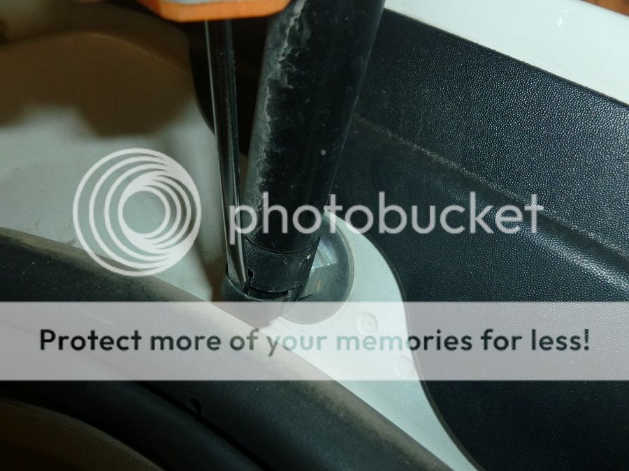

These are clamped on to ball joints. All you have to do is use a small screwdriver to pull back the metal clips. Here’s the top:

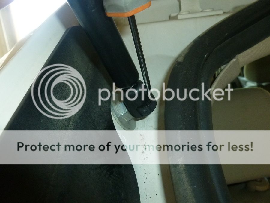

Here’s the bottom, you can see there is an indent for where the screwdriver goes. The indent is in the top as well, but it’s easier to show with the lower clamp:
Just slip the screwdriver right in and the support will come right off:

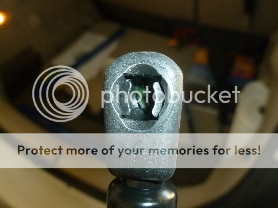

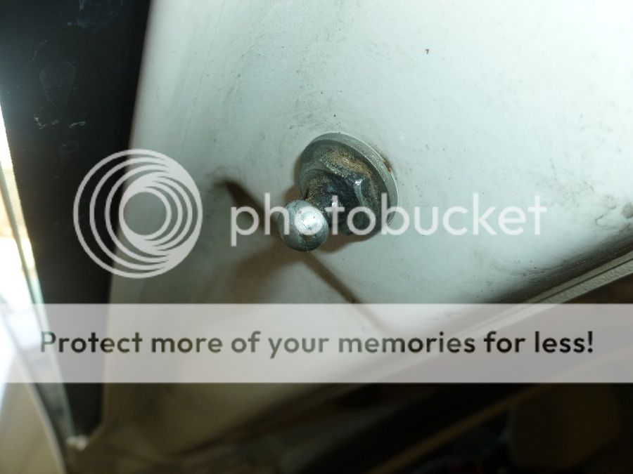

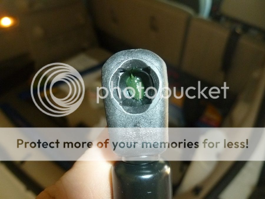

Here is the ball joint that the supports attach too (cleaned up). It is the same top and bottom:

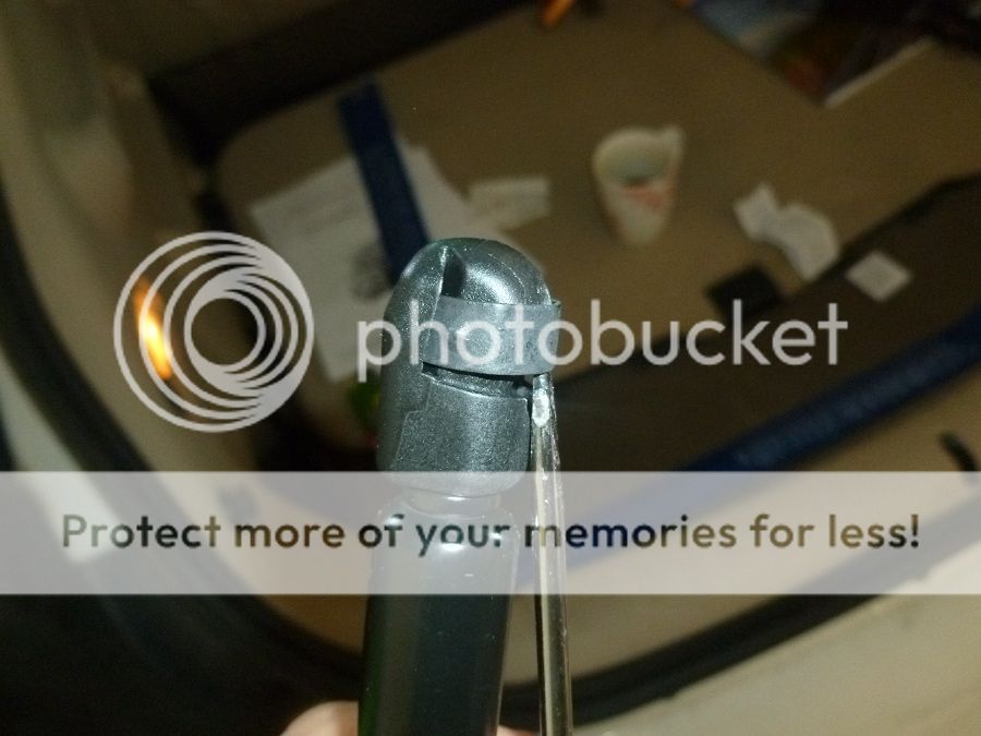

Here is the opening so you can see how the clamp works. This is with the clamp snug and not spaced out:

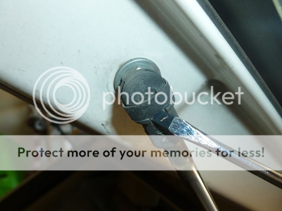

Then you slip the screwdriver into the clamp to spread it:
And the inside edges spread back so you can slip the old one off and the new one on to the ball:

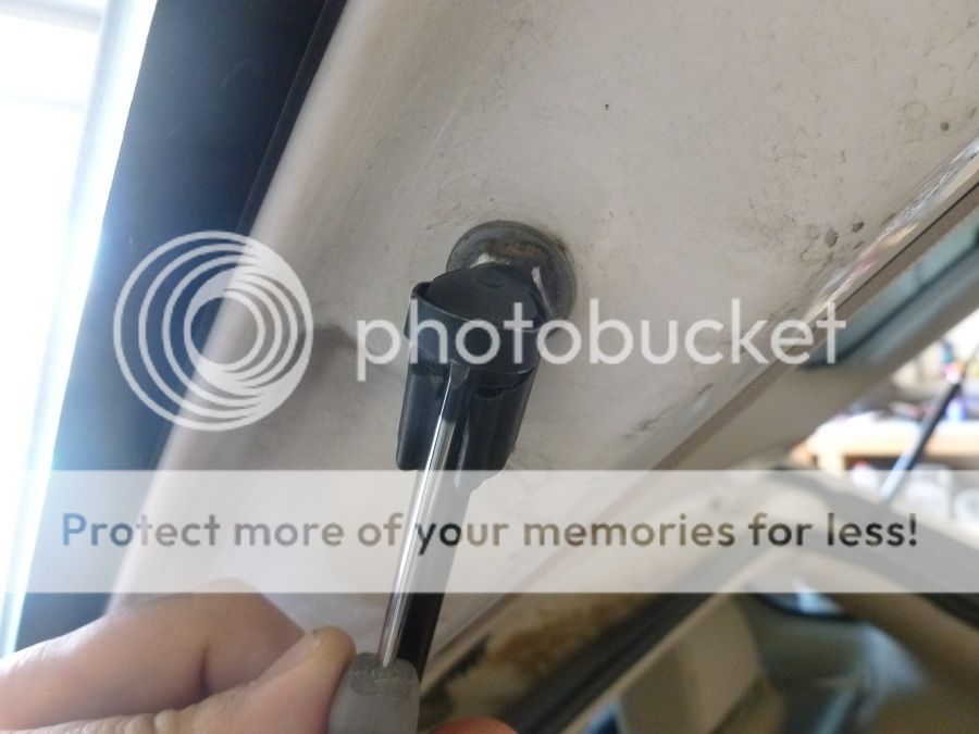

All you need to do now is reverse the process. Spread the lower clamp and slide it over the ball:
And to the same to the top:
And just like that you’re done! Pretty simple fix to make sure your hatch stays safe. Once the new ones were installed it was night and day opening the hatch. It pops right up now, before we had to lift it almost the whole way up until the supports were able to hold it up.
