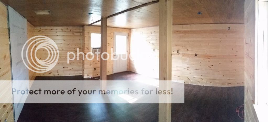

CCC - Part 5 - insulation, wrap, and ceilings
With framing and electrical in, it was time for insulation.  I used paper-faced batt fiberglass that fit nicely between the 2X4 framing.  The paper faced into the room and it was relatively easy to staple it to the 2X4’s.  Of course, slits had to be made to work around the wiring, and notches cut out for the electrical boxes.  One thing that’s an oddity about container construction is the use of a vapor barrier.  Being wind and weather tight naturally, there was no need for it on the “outside” part of the framing.   No leaky drafts here!  However, there would be humidity in the air inside the cabin.  With the paper facing in to the cabin, there is some barrier, but quite enough.  If the warm interior air were to penetrate the finished wall and insulation, it would hit the cool steel and condense.  No good comes out of water running down a steel wall in an enclosed space.  To add another barrier layer, we stapled large sheets of 6mm plastic over the paper.  We over lapped the edges and used home wrap tape to seal it all up.
Once insulation and wrap were in place, it was time to put up the finished ceiling.  We used ½” plywood sheets that I pre-stained.  I was really wasn’t looking forward to all the overhead work, and though long and hard about how to save my back.  I ended up buying a used, but practically new, hand-cranked drywall panel lift for $100 off of Craigslist.  I also used the lift to help put in the top bunk of the bunk beds.  I generally worked by myself, and by loading, raising and locking the panels to the ceiling, the lift was a godsend!  The plan was to sell the lift after this project was over, but I think we’ll keep it
A quick note on work conditions.  This project has taken about 2 years to complete.  Its not uncommon to get 104deg with 100% humidity in the summer and subfreezing temps and snow/sleet/ice in the winter in the Ozarks.  Our 17yo daughter and I moved the containers in during the hottest part of July.  Being an Eagle Scout and Marine, I’m accustomed to working outdoors in poor conditions.  However, I’d been out of the Marines for 10 years and age, conditioning and concern for my daughter dictated that we  pace ourselves and took  lots of breaks to hydrate.  We were camping on the property, but by the end of the day we were generally so exhausted (and desperately wanting some air conditioning) that we’d just go into town (20 min drive) for dinner.  Having a fire, let alone cooking over it, was way down on our list of things to do.  In the winter, I’d generally go alone.  I enjoy the solitary time with a project and radio.  Not so much my family.  When the weather got cold, I pitched a small free-standing tent in the cabin, stuffed in an air mattress and rolled out my sleeping bag.  When it got really cold, I moved a small electric heater into the tent.   With only me in a 3-person tent, there was plenty of room to safely operate the heater.  Slept like a baby every time.  The only problem is that there was so little light in the cabin, it was easy to sleep in.
Im not done writing this up, but I should give credit to the folks that helped out.  Besides our daughter, my wife also has helped.  She’s the one working in the grinder picture before.    Our 12yo son helps out where he can, mostly collecting firewood, building and tending fires, and driving the occasional screw (he helped build the bunk beds).  I also had a couple of friends come down to help pier and level the containers, prep and epoxy the floor, and put in the finish wall.  Just to show its not all work, I've added some pics below.  Many thanks to everybody, and I’ll write more tomorrow.

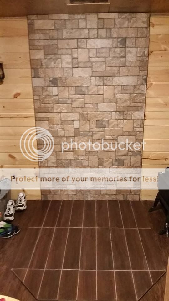

CCC Part 6 Interior wall finishes, flooring, stove stuff, and cabinets
With the framing, insulation, electrical rough-in, and ceilings up, it was time to finish the walls.  Just like other's on the forum, there was to be no dry wall in the cabin (lookin at your statesofmind!).  Instead we decided to go with 8" tongue & groove (T&G) knotty pine boards.  With the height we had to work with,  13 rows fit perfectly.  The small gap at the top is covered by 1X4 pine trim.  We put the T&G boards in the cabin a week before our planned install to give them time to adjust to the local humidity.  With a buddy and a couple of heavy brad nailers, we got it them installed in a day.  The next day we polyurathaned the walls.  Trim was going to have to wait until we cabinets, bunk beds, and the closet were put in.
With the walls up, it was time for flooring.  Another buddy and put down a snap-lock laminate floor that mimics scrapped hardwood.  Again we put them in the cabin a week ahead of the install.  Yet another buddy helped me put the flooring down in a day.  The laminate looks good and should be durable for a good long time.

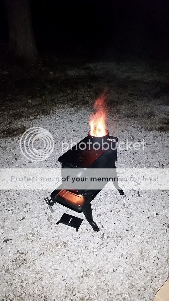

For a wood stove, we bought the smallest model available from Northern Tool.  Normally, I wouldn't advocate this model as its small and somewhat inefficient.  However, for the sqft we needed to heat, the insulation and airtight space, small footprint, and infrequent use it would get, it fit the bill.  Even though the stove's footprint was small, it sticks out into the room a good 4 feet.  To safely reduce the distance to between the wall and back of the stove, we needed to create a non-flammable barrier with a minimum 1-inch air gap to another non-flammable wall covering.  We screwed cement board to the framing, then screwed a second layer of  cement board to it using 1" sections of pipe (cut-off's we bought cheap from the local metal shop) to create the necessary air gap.  Over this we put on tile that looked like a stone wall.  To protect the floor from errant sparks, we put down tile (over more cement board) that closely matches the laminate.
We had previously left a gap in the ceiling framing, insulation and plywood covering to fit a ceiling support for the stove chimney.  Word of advice, buy ALL your chimney components at the same time from the same store.  Even if you have to take things back later and get a refund, it will be worth it.  Not all components will fit from different manufacturers and you'll save yourself considerable time and headaches getting it all at once.  Ask me how I know.... >:(
Having cut out an appropriate sized hole in the roof, we slipped the ceiling support in and screwed it in place.  From the top of the stove to the top of the chimney is 10ft straight up.  First we placed the interior single-wall pipe into place and secured each section with three self-tapping screws at each joint.  Next we moved up to the roof to put in the exterior double-wall pipe.  This pipe is stainless steel, has insulation between the walls, and twist locks into the ceiling support.  Needless to say, its fairly expensive so were glad we only needed one section.  On top of the pipe goes a spark arrester / rain cap.  There are two rings that need to go around the exterior chimney.  The first ring is about 8" tall and goes around the base and acts like flashing to the roof.  Since the roof is made of corregated steel, we had to use a pair of tin snips to match the profile.  We then used high-temp caulk to seal the gaps.  The second ring is about 3" tall and clamped a couple of inches above the top of the  first ring and gets more of the high-temp caulk as well.  This acts like an umbrella for the first rings seal to the chimney.  We probably could have gotten away without this second ring, but its cheap insurance against a leaky roof.
One thing we had to accomadate for was the flex in the corragated roof.  As we moved around the chimney, we noticed the roof kept pulling away from the flashing. To minimize the flex caulked what we could reached from a ladder and did the rest at arms length while laying down on the roof.  By laying down we distributed our weight out like they tell you to do on thin ice.  We got it all sealed up but it's something we have to be aware of whenever we go up on the roof.
Firing up a brand new stove can be an exciting and stinky time.  The oils from manufacturing and paint need to burn off/in.  I was very grateful to get some advice to do the first burn outside, clean it out, then take it in for permanent placement.
