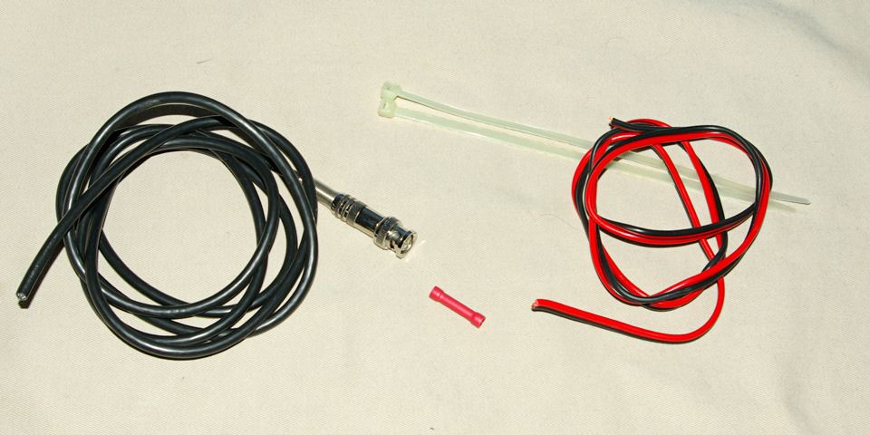

Starting with simple materials.

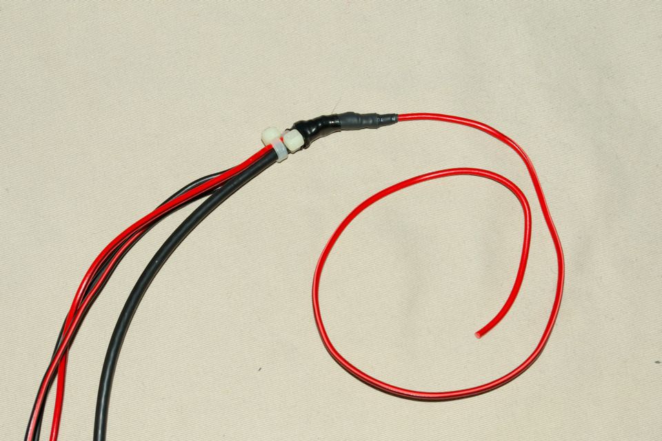

These are 4 pieces of 1mm speaker wire, a length of RG-58 coax, a electrical crimp connector , some zip ties and some heatshrink tubing.

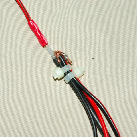

First assembly step.
One can also strip the braid out of a length of the coax, and use the core as the vertical element. It saves the hassle of joining the wire to the core.
But 2 yards of coax was what I had available at the time, so I proceeded with adding the l/4 wire...
Half-done with a lot of reinforcement on the connection points.

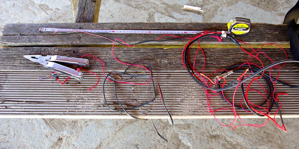

The rest of the assembly was done in the field.
It is messy but it will all come to being clearer

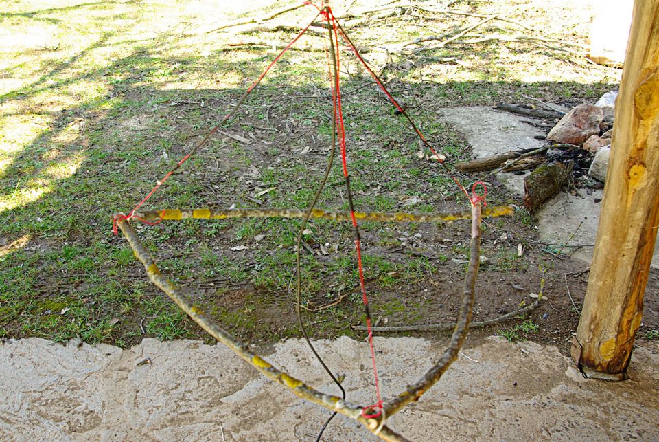

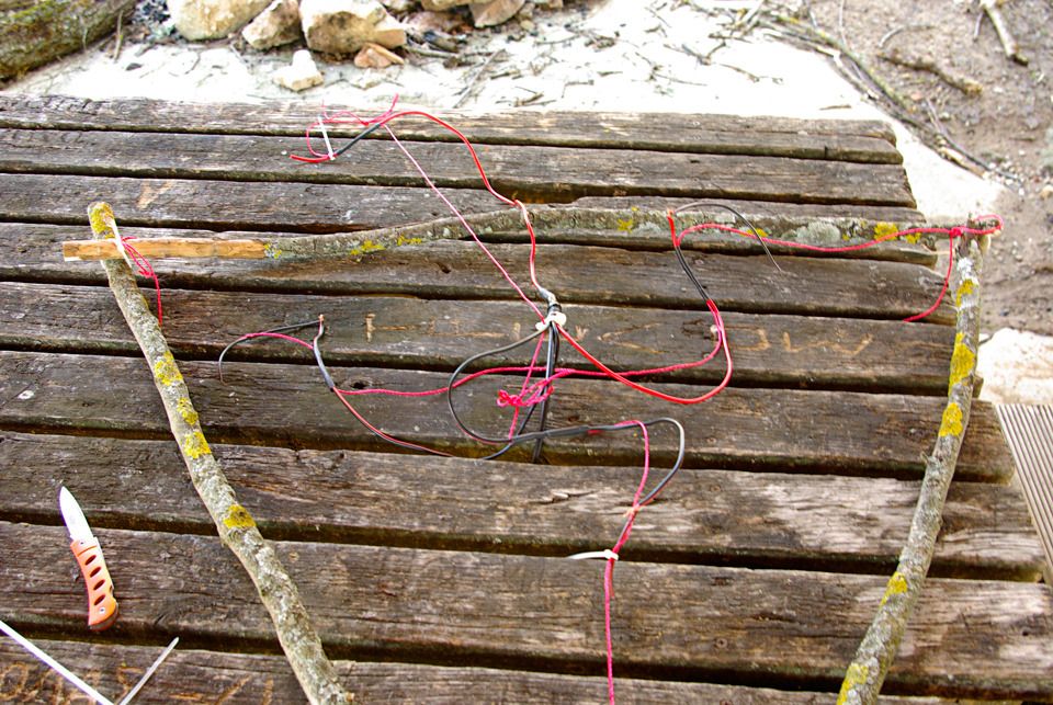

Building the frame.

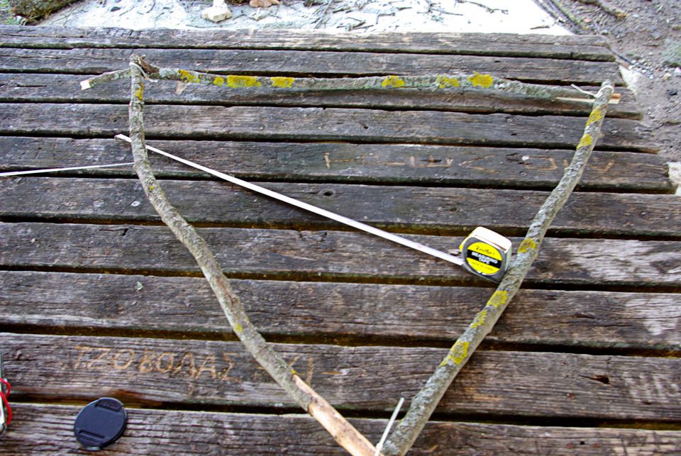

The radiators must be set at an angle of 45 degrees for the antenna to have an impedance of 50Ohms. So one slow night I sat down with a beer, a notebook and a scientific calculator and found out the frame and rigging dimensions.
I chose to have rigging strings longer than the wire, and decided on 60cm long. That dictates frame legs 73cm long.

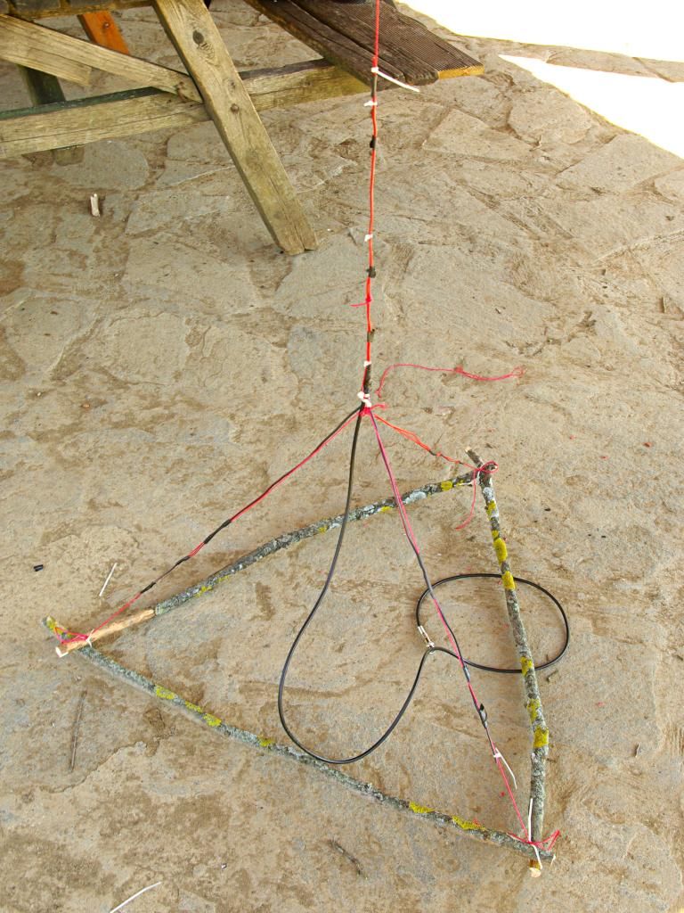

And tie downs start to happen.
Finished up and hoisted.
The  wires were attached on the strings with a jumbled mess of electrician’s tape and zipties. But I will soon be heat shrinking the whole length.
And this is a posed view with element dimensions added.

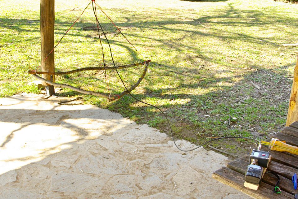

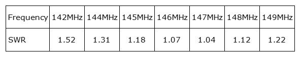

Tuning
Notice the rookie mistake?
I kept removing 3mm (1/8”) at the time from the main element. When I called it quits these were the SWR measurements.
I was aiming for best SWR at the 145Mhz which is the lower limit of Greek HAM repeaters’ input freqs.
I missed it by some margin, not for overcutting, but for allowing ground effect to creep in. Antenna was kept at a bit over 1 meter from the ground to facilitate adjustments.
When I realised this I hoisted it above wavelength and took the final measurements above.

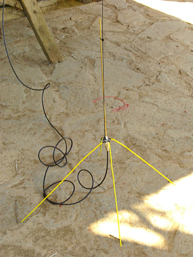

With the occasion I also setup my other ¼ groundplane, one made from single strand copper wire and a brass soldering rod (for the vertical element).
Here it is, posed on the ground.
I grabbed the chance to also “study” ground effect on tuning.
On the ground SWR was 1.37, 1meter over was 1.25 and raised above 2m SWR fell in the expected region of 1.05.
That was some lesson to be learned!
