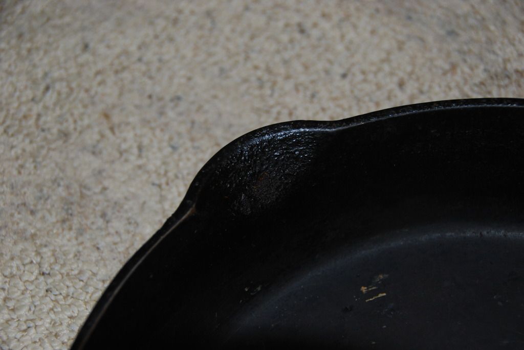

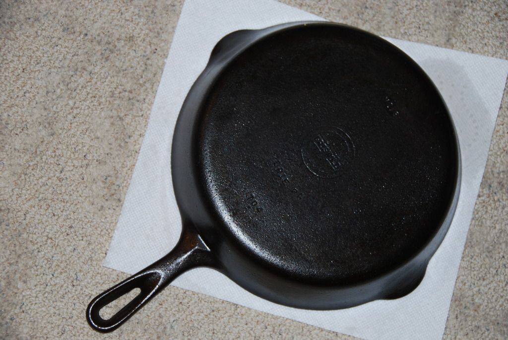

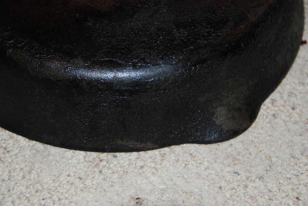

Mom visited last week to see the baby and she brought some toys. Along with homemade quilts for the baby and one to hang in our entry she brought me my grandmother's old cast iron pan. A genuine Griswold. I was elated. One small problem... After years of use it had a bit of carbon on it. Enough that it didn't sit level and looked a little worn.

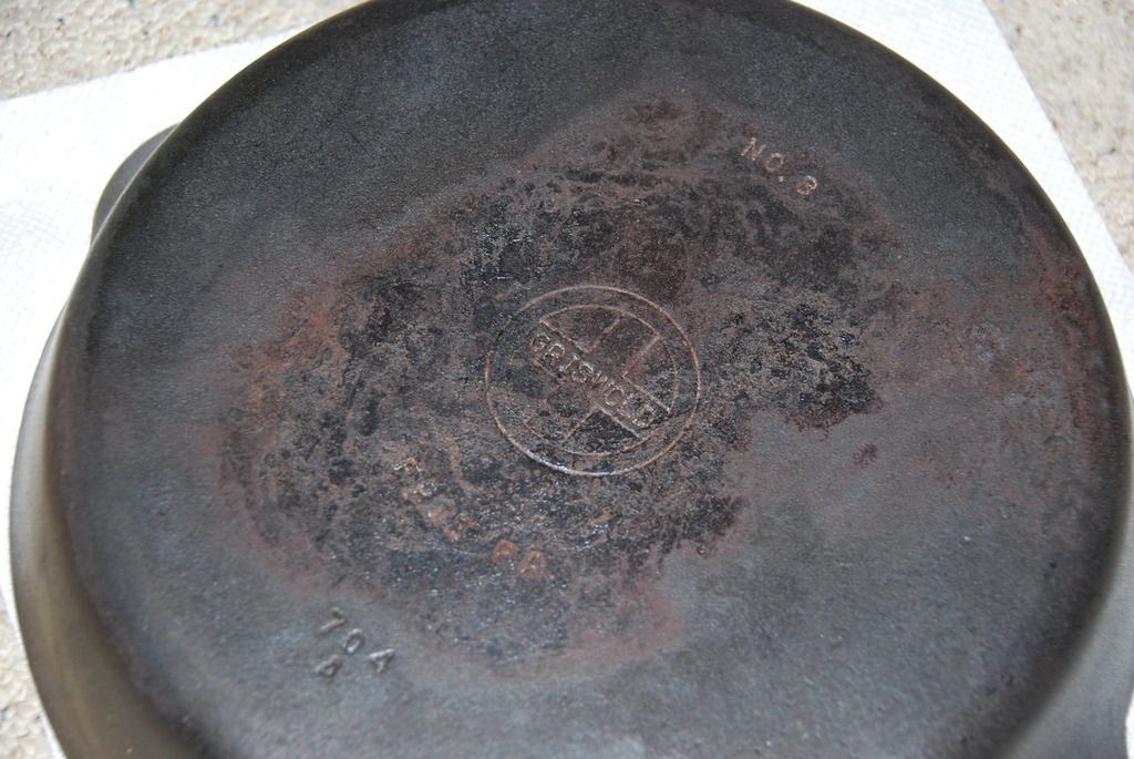

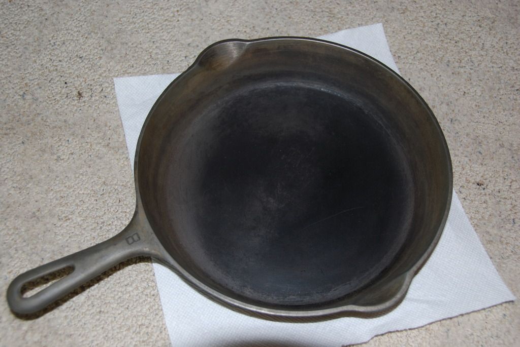

Following their method I soaked the pan overnight in a 5 gallon bucket of water with 1 lb of lye mixed in. At this point I should note that lye is not a toy and should only be used by those of us who know what we're doing. I was hazmat certified when I was in the food industry and took proper safety precautions.

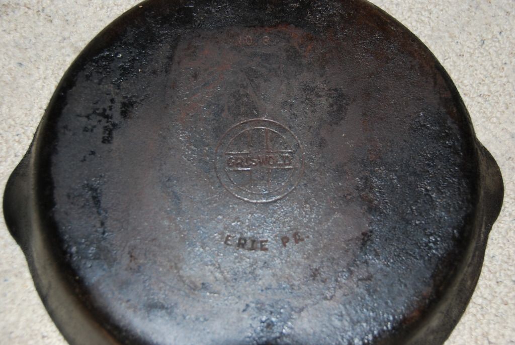

After the one day soak I scrubbed off the remaining seasoning. It was a little scary seeing the bare iron but I was on a mission. It came off pretty easy along with the built up carbon. Once clean I dried it and rinsed (no more lye) and gave it a rub-down with vinegar. A long exposure to vinegar will eat the iron but a quick rub helps  get any rust spots out. The stripped pan looked something like...

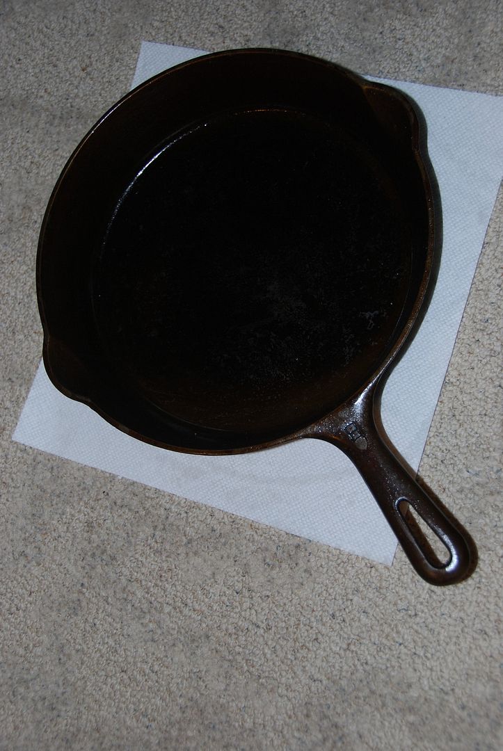

Unsettling, I know. You can even see the machining marks. Yikes. I immediately rubbed it with sunflower oil and put it in the oven which I heated to 400f, held for 15 minutes, and then let cool. Repeat. This morning I fried my eggs on my brand new (very old) Griswold. Now it looks pretty good...
I don't know if I'll use it full time. I spent years seasoning my old Lodge to be "glassy" and I have no problem with it. Maybe I'll hang the Griswold on the wall as decoration (it's kind of food nerd art) or maybe I'll save it for my daughter. I haven't yet made up my mind. But it sure is beautiful.
