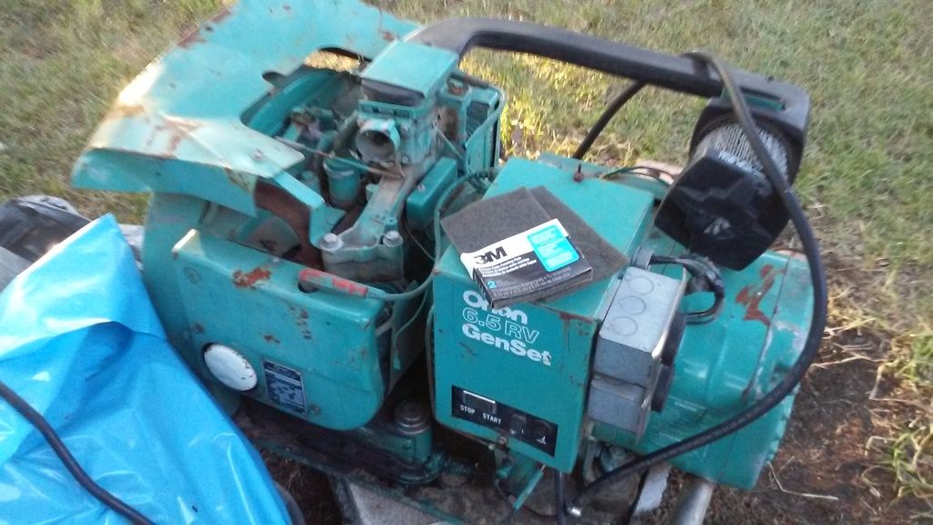

This generator was originally installed in a motorhome. I purchased it from a scrapyard, so I don't have any information at all regarding it's past other than what I can deduce from looking it over. Since I don't know the history, I'm checking everything over and repairing anything that needs it before trying to start it. Someone has added two 120v RV outlets, as none were originally present with the unit hardwired into the original RV. Slip ring cleaning is not as critical on this genset as on the 6.5NHE I mentioned earlier because it lacks those expensive electronic controls, but it's still good policy to clean them. The gray scotchbrite pads you see on top are what I used. Don't use sandpaper or emery cloth as both will break down and the abrasive will embed into the soft copper slip rings and/or the brushes. Red scotchbrite pads would work a little better, but this is what I had. You can also purchase and use a commutator stone.

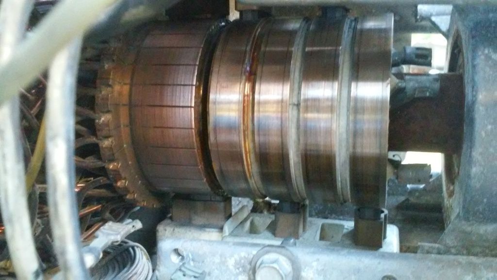

Here are the slip rings, and at the far left end of the rings is the commutator, which isn't going to be present on most sets. I'll talk a bit more about it later. I've cleaned the two slip rings on the right. These were surprisingly clean to start with, so it's harder to see the difference. I've seen far worse.

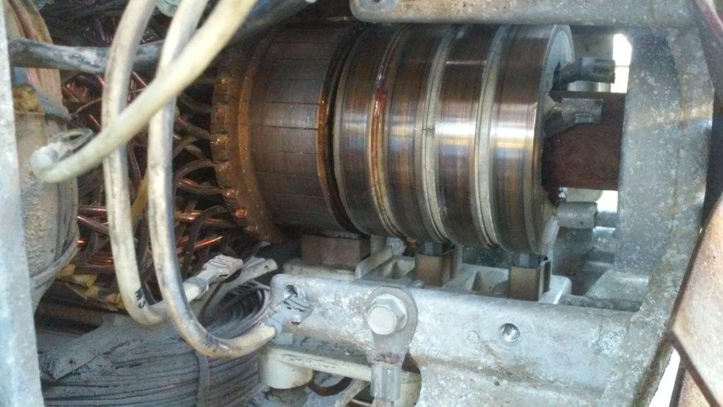

And here I've cleaned the other two, and the commutator.

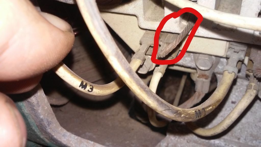

In the pictures above, two of the brush holders and brushes can be seen at the top and bottom of the slip rings. There is another on the opposite side, and one was removed to access the slip rings and commutator. All of the brushes need to be checked to ensure that they move freely in the brush holder.  This is done by gently pulling the braided wire attached to the back of the brush. This set has 12 brushes in all, and some of them were very lightly stuck. Only eight of those brushes are for transmitting 120/240 volts though.  ;) All of the connections to the brush holder need to be checked to ensure they aren't loose, broken, or heat damaged. Here is a picture with the braided wire circled in red and some of the connections on this brush holder.
