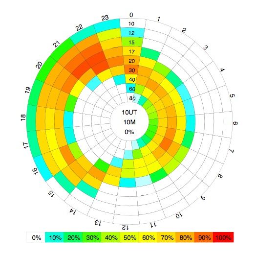

Spoiler alert: here come my answers.  May not be the right ones, they’re certainly incomplete, but here goes.
Q1: What frequency segment and time will you select to minimize DF likelihood and maximize the chance that HQ will acknowledge it?  What will your alternate(s) frequencies be, and under what circumstance will you use them?
After playing with http://www.voacap.com's point-to-point predictions for a bit (result plot below) I'm going with 40m @ 0830z as primary.  The reasons for this are (1) it's in the dead of night so we're less likely to be seen, and (2) the message being passed was received just after dark, and this is the soonest window.  For secondary, I'll go with 17m @ 2200z.  Both of these are centered on the red-est, most probable checkers on this plot:
Could've also gone with 20m @ 2230z, but it's a lot easier to get a 40m antenna to tune on 17m than on 20.  BTW, this was done with the model input set to 100w CW (about equal to 20w PSK31), with dipoles strung at 50’.
