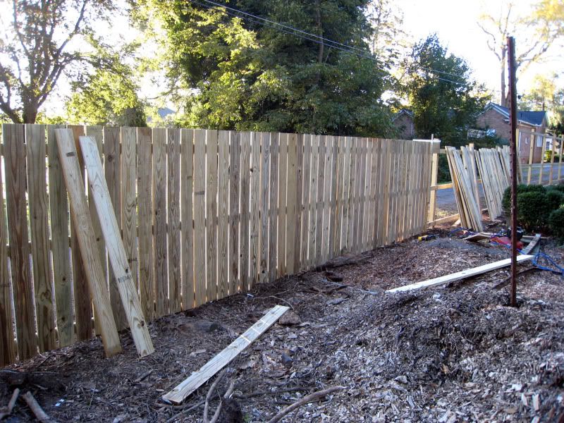

I went to the trouble to nail all the top risers at the same level perfectly horizontal; I did this so that I could then use them as the reference to set the boards evenly and on a level course.
Jig time again-
First “jig” was an 8’ 2x6 that would sit on top of the top riser and provide the marker for the top of the board.   I used a sheetrock square with this to align the top of the boards with the edge of the 2x6.
Second jigs were the two spacer boards for proper spacing (duh) and to insure I was keeping all the boards on a perfect vertical alignment.
Finally I kept a level handy and spot checked each board once nailed to the top riser before tacking it in to the middle riser.
Here is the “system”, the 2x6 on top of the riser, the framing square and the two spacers. The spacers are short sections of 1x2s with long decking screws positioned to allow them to hang on the risers without shaking off when the next board was being aligned.
I used a finish nail gun to tack up the boards before coming back with ribbed decking nails.  This way I could knock out the tedious “precision” stuff quickly then make the permanent attachment “hands free”, with the boards already tacked up.
Progress, front and back:

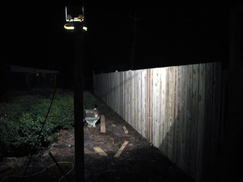

And finally the main run of the “short” 6’ portion of the fence, which was finished under the trusty 300 watt halogen shop light:
I still have a lot of the permanent fastening to do on this run but it is basically “up” as planned.   (I'll cut off the tops of the fence posts that extend above the top of the boards).
This week I will have the 8' boards delivered for the "tall" part of the fence and hopefully make some headway there as well.
