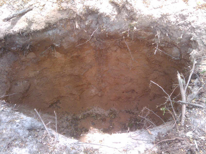

As this is my first post, I'll contribute a bit on what I've done.
There is a caveat to this, my BUL has no running water via well or public service.  Right now, we have a nearby community well that we get water from, and transport it via 250/300 gallon totes to elevated water towers, powered by 12v water pumps and car batteries.  That being said, this dry well system will not hold up to large quantities of water from a well or other means (I've seen a house flood from it), but works great for our system.
In my Septic System, I used the following materials:
(3) Plastic drums - 55 gallons work fine, but I used pickle barrels because I got them for cheap.
(2) 2 foot sections of 4" PVC - I got this for free on Freecycle (freecycle.org)
(1) flexible 4" yard line  - Again, I got this for free on Freecycle
(1) Can Outdoor sealing foam (window/door works fine)
(1) Propane torch - I had this at home, but not at my BOL, so I bought an extra one.
The open end of the barrel goes face down, allowing the sewage to flow through the sand and be filtered.  The maintenance of this system is 1 can of fruit cocktail, once a year.
A friend of mine built this system previously, and he put his PVC through and used gaskets and connections.  I improved on this method a bit by heating up the barrel with the torch and pushing the PVC through, ensuring a good fit.  I just used  the insulation around the PVC connections to ensure a good seal.  It was probably unnecessary, but seemed to work out pretty well.
The flex hose will be my camper's connection to the septic system.  I just got the 5th wheel camper, and will be pulling the plumbing to reuse and store the gray water.
I then dug a 7'd x 4'wx6'l hole (by hand).
I will take more pictures of the setup up there (including our battery bank electrical system, water towers, and because this BOL receives up to 30' of snow during the winter, the canopy roof I will be building over the camper.
We will also be digging a root cellar for food and water storage during the winter, as everything we have freezes during that time period.
I'm also getting ready to test out a very inexpensive geothermal system for general heating/cooling up there.  I'll post more when I've tested it out.

This is a real winner!  I have seen a much cruder system with only 1 barrel divided by wood (for solid/ liquid separation) used daily for 10 years by 4 people.  If, in the future, you have a problem with leaching you could add leach lines, or a pit at the end last barrel. The relatively small leach area was the only drawback to the system I mentioned.

That's a really good idea adding a pit to the 3rd barrel.  The ground below 4" is pretty much solid sand, so I'm not excessively concerned about leaching, but I have seen the results of it.
Also, in reality, this system cost me approximately $30, but depending on prices and what materials you can find, it could cost more.  I can also add additional barrels at any time...  I have another 10' of pipe and 3 more barrels, but for the primitive living we do up there, it works out great with just 3 barrels.

Would there have been any advantage to put the coorgrated piping off the bottom of the drums kind of like a drain field? This is a great idea!

Absolutely, that would add in the leach field.  If we ever do put in a well, I will be putting in a leach field off the set of barrels, but for right now, it's not necessary.

I have heard that bread is a good periodic treatment for good septic tank health, what is the impact of the fruit cocktail? Sugar?

My late father-in-law built a similar system for the bathroom in his pool house. We dug 2 4'x4'x4' pits put a 6" layer of gravel in the bottom of each. Drilled numerous 1/2" holes in the first barrel from about 3/4 way up and on the second barrel from about 6" up. Placed each barrel in the pits and connected them with a 3" pipe near the top. Poured gravel around and on top of the barrels and covered them with about 6" of dirt. It is still working 12 years later.

Bread would make a good substitute.  The idea is the sugar.  The enzymes will break down the solid waste matter, and the sugar helps them to grow (much like dry yeast).  Fruit Cocktail just slides down a toilet easier than a bag full of raw sugar.  This AP article has some interesting information on the commercial brand of Rid-X: http://www.associatedcontent.com/article/313183/ridx_septic_system_treatment_product.html
I'm being rather clueless today, can you explain a little more how this is setup and how it works? thanks
Sure, the concept is the same as any multi-stage septic system.
The first barrel takes the waste (ours is gravity fed from a camper).  The waste hits the bottom of the barrel, and natural rainwater, toilet water, and ground moisture help dilute the wastes, which will leach through the gravel/sand underneath.  The second barrel is to provide additional protection, in case the septic system gets heavily used.  Rather than backing up into the camper, the waste level will rise up and flow into the second barrel, where the process happens again.  The third barrel is yet another fail over.
