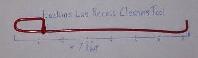

how to make an AR-15 "star chamber" cleaning tool
« on: November 10, 2008, 10:12:42 AM »
As I am a cheap bugger....
This tool makes cleaning the "star chamber" (where the locking lugs on an AR type bolt fit)  that much easier. Use a plastic coated coathanger if you can. Wrap cleaning swabs around the tip. Folds in half to fit in the butt trap, too.

Now that is creativity!
