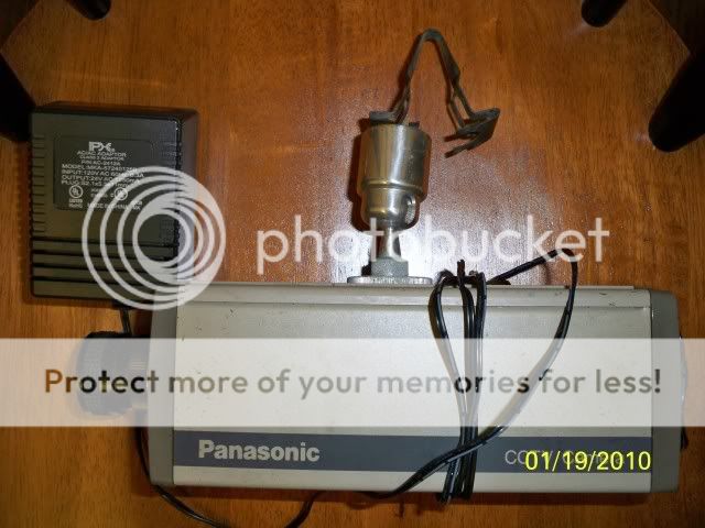

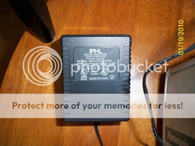

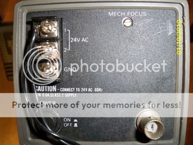

Tim's Bootleg/DollaTree/DumpsterDivin Video Cam Recipe:
Ingredients:
One Panasonic CCTV Camera (slightly used and appropriately soiled - dug out of a gas station dumpster)  $000.000
50' cable with 2 BNC type connectors  WallyWorld    $6.96
1 BNC/RCA Adapter  Radio Shack    $5.99
1 24v AC Power Supply  Local Electronics Supply Store    $19.99
Total Cost (NOT including a couple of squirts of Windex to get all the crude off)  $32.94
Directions:

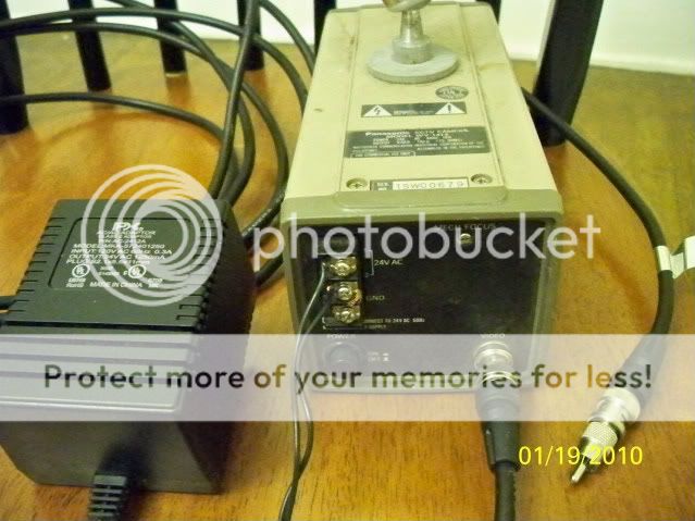

Take one used CCTV, remove surface crude, clean lens, inspect.
Add one 24v AC Power supply.

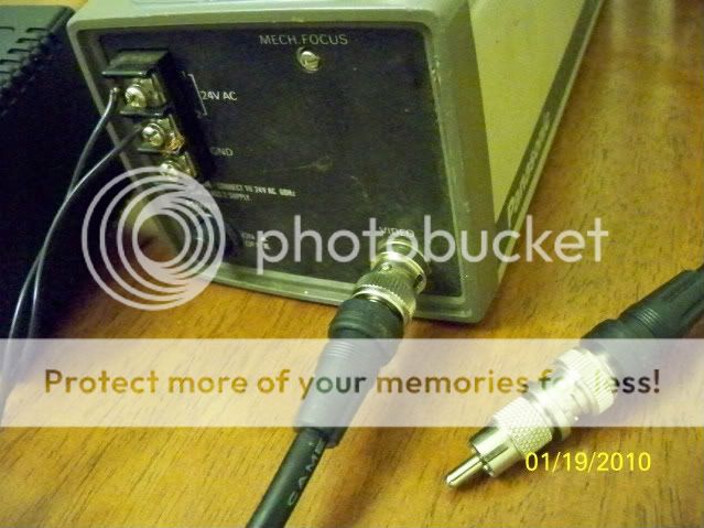

Add 50' coax cable w/BNC connectors.
Add BNC/RCA connector adapter.
Sit back, smile at your collection of parts and pieces.
Connect BNC connector to camera.
Connect 24v AC Power supply to camera.

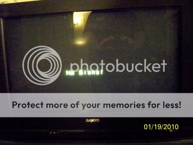

Plug RCA adapter into "Video In" on TV /VCR /DVR and turn TV on.
Whoops...  Plug in 24v AC Power Supply and turn CCTV "On" and you should have a picture like this.

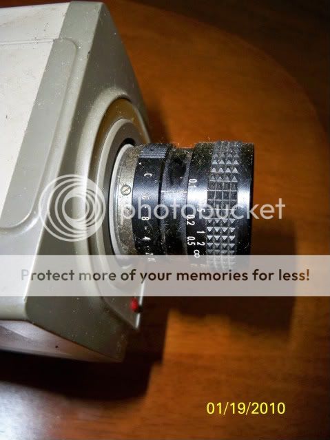

Adjust lens on camera for best picture (this camera has both aperture and focus adjustments).

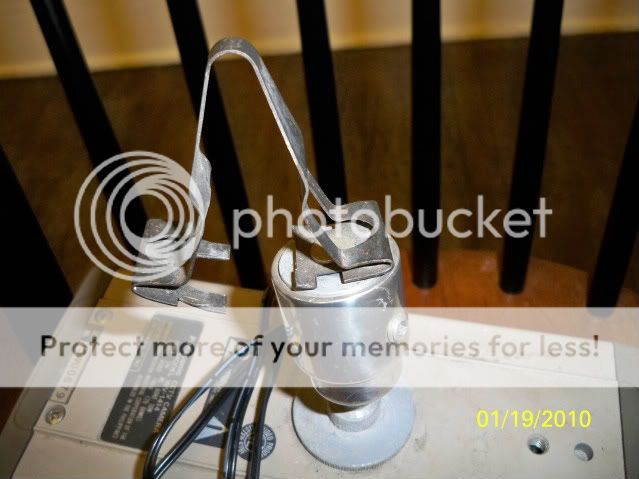

Close up of mount (This one is for "suspended ceiling tile" rails).
The picture was really fuzzy and weak at first, wiped off more crude from the lens and gave the camera time to warm up a little and things got a lot better.  In the end, a very suitable image for a "dumpster cam".  The easier and much higher quality setup would be either the wired (coax and power supply) camera sold at WallyWorld for $39,96 or their "Wireless" version for about $70.00.  As soon as I get my hands on either (soon I hope) I'll post the setup on them.  Enjoy!
Tim.

Tim, great one.  Love the pictures really puts the equipment into perspective.  (Is that you in the monitor  ;))
