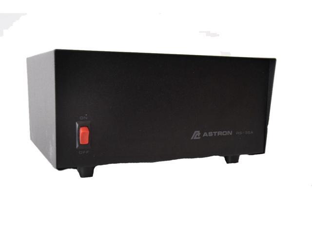

If size and weight are not an issue, I'm a fan of the Astron 35 amp series.
I got a used one from the 1980s for $80.  It's user serviceable for the most part and works great.  You want a minimum of 20 amps for 100 watts, but really you should plan on 30 or more, depending on duty cycle and modes.
I will say that a quality battery with good discharge characteristics is not a bad option, but you would likely want an elegant solution for charging, like a PWRGate, but that requires an powersupply to charge the battery(ies)

Just keep in mind that a 100W radio like an 857D is 100W output, and the efficiency is maybe 50% or less. The radio probably draws 22 A or so, which means it needs a 300 W power supply (22 A * 13.8 V).  A 25 A peak 20 A continuous would be the least current of a proper power supply for that radio.
